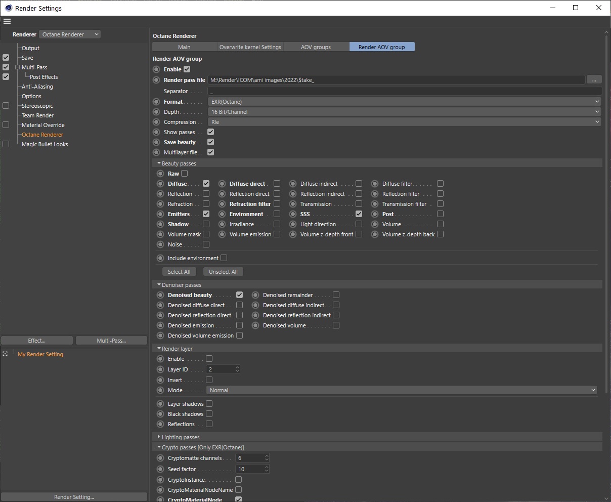

Having issues again. For some reason I can't get render passes to save my EXR.
In the log I get a message that says:
not all the passes requested for tonemapping are enabled
None of the requested render passes were enabled.
failed to save multi-layer EXR
failed to export render passes
But it is enabled.
What is the trick to making Octane save a render? It shouldn't be this difficult.

jayroth2020
Posts: 487
Joined: Mon May 04, 2020 7:30 pm
You should submit a support ticket to [email protected]. Do a "Save Project with Assets...", archive the result, and include it with your submission.

Posts: 16063
Location: Türkiye
adrencg wrote:Having issues again. For some reason I can't get render passes to save my EXR.
But it is enabled.
It's not hard in reality. Probably you have something unsupported(ex. using non-english chars on saving) or missed an obvious stuff. Please do what Jay says.
