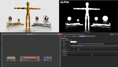

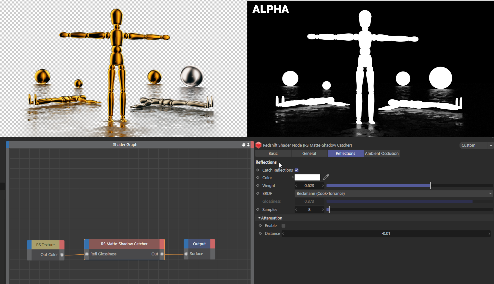

Hi Bepeg, I don't think you understand what I'm asking for. I'm fully aware of AOV's and use them every day, but they require you to render out on black and depend on blending modes, this doesn't work well on solid backgrounds. Even the layer reflections AOV. The only thing you can render directly to an alpha channel is a shadow using the shadow catcher material.bepeg4d wrote:Hi,

I've been learning Redshift over the weekend and it's incredibly simple to do what I'm asking. You can literally add the reflection to the shadow catcher material and you've instantly got an alpha reflection that works perfectly on both black and white solid background.You can even add bump maps and roughness and this all affects the alpha channel too..(it's mind-blowing how easy it is)
Like I said in my original post, my clients need assets on a clean transparent background. It's not that crazy of a request, but it causes me heaps of photoshop work.
Just look at the difference between the Redshift shadow catcher and the Octane one...Octane is literally just a single checkbox in the common tab of diffuse material..Hardly has much option to adjust.. Redshift shadow cacther is extensive tool, as you can see in above screenshot.
