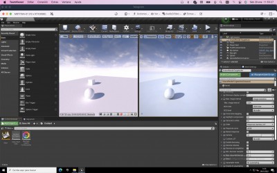

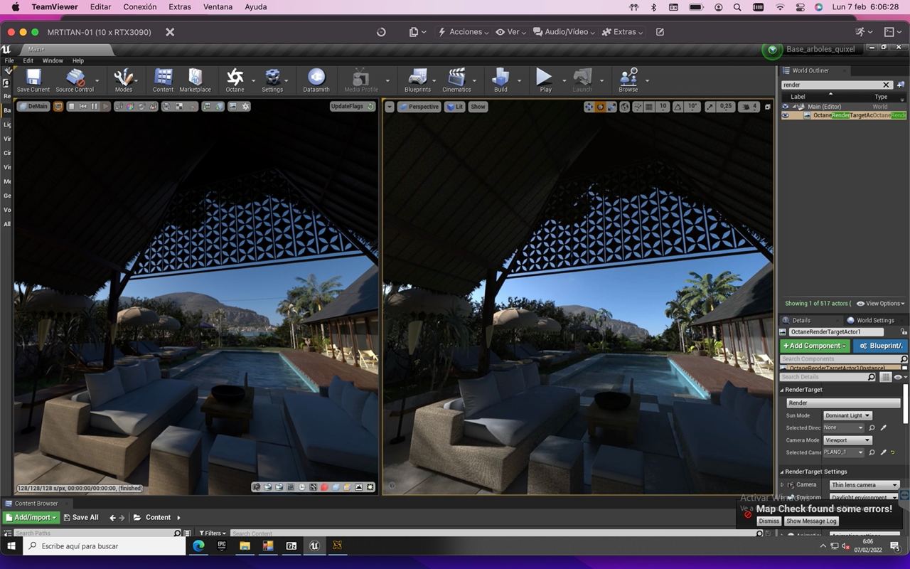

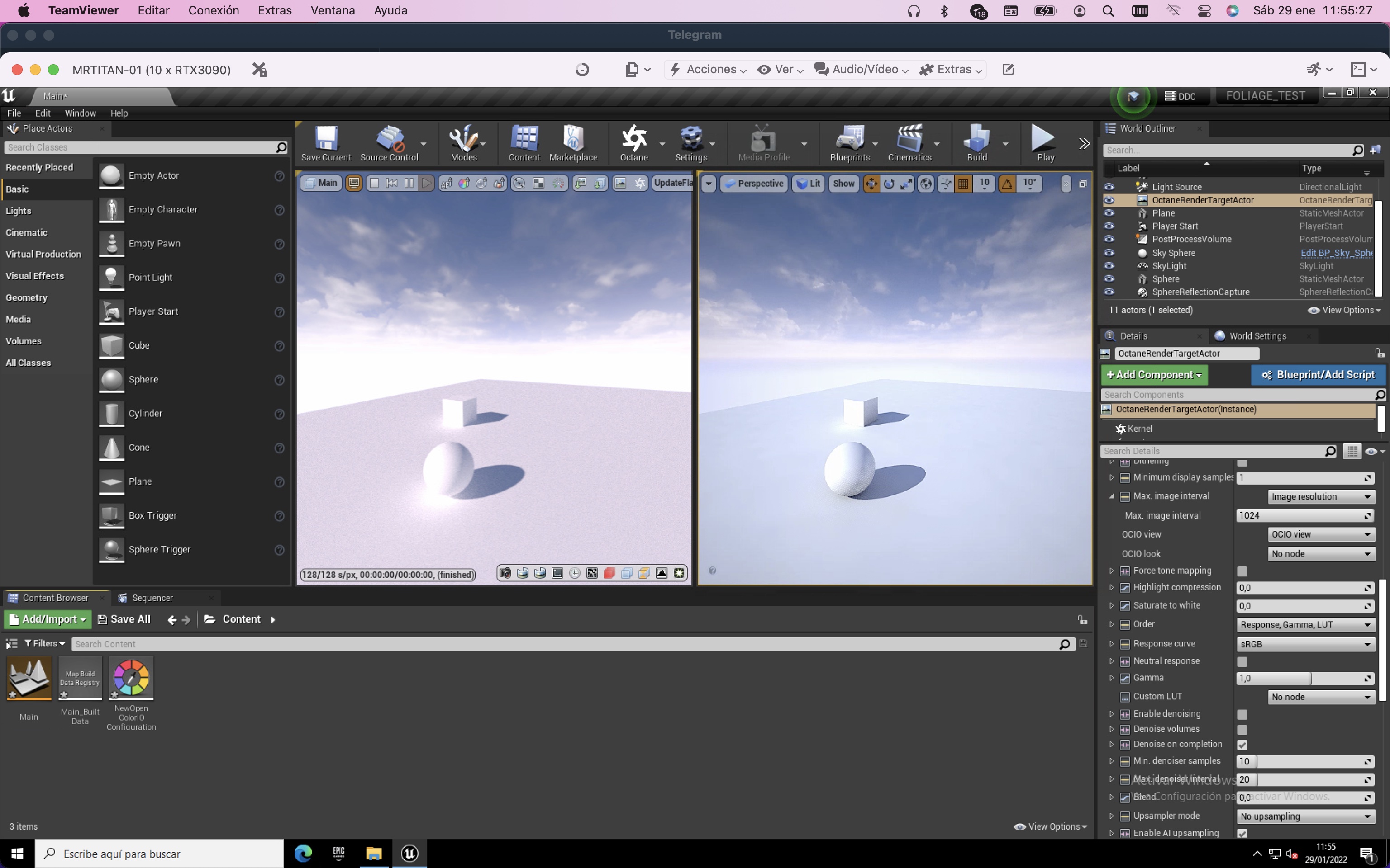

Hello, there is a color difference in 4.27 between Octane Viewport and UE4 viewport.
I've been trying to match colors using Ocio either in Octane or UE4 but can't find the way.
Questions:
Is it possible to match colors between UE4 and Octane plugin as it was before?
How can i use Ocio within Octane Render Plugin for UE4?
Thanks for creating great software.

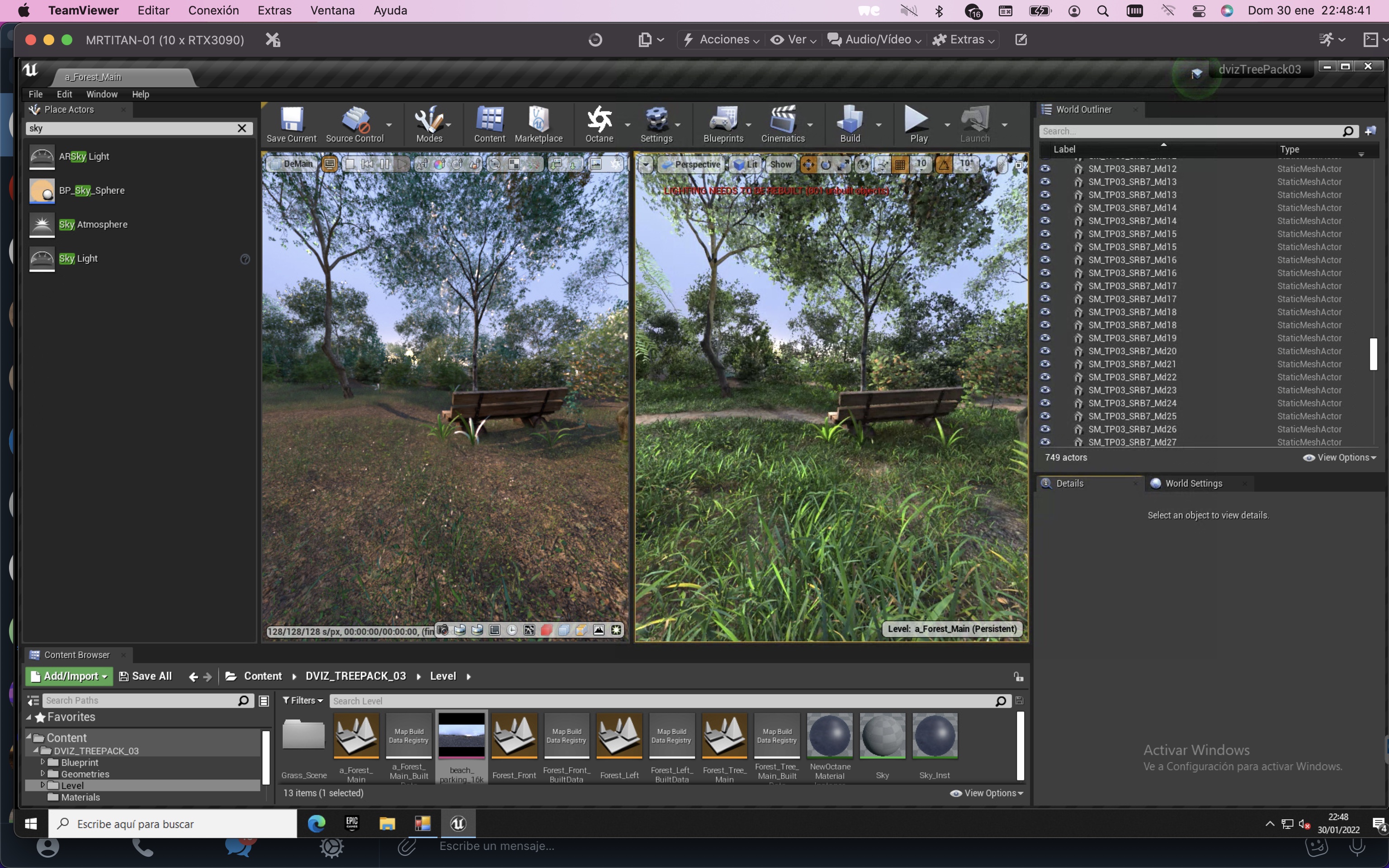

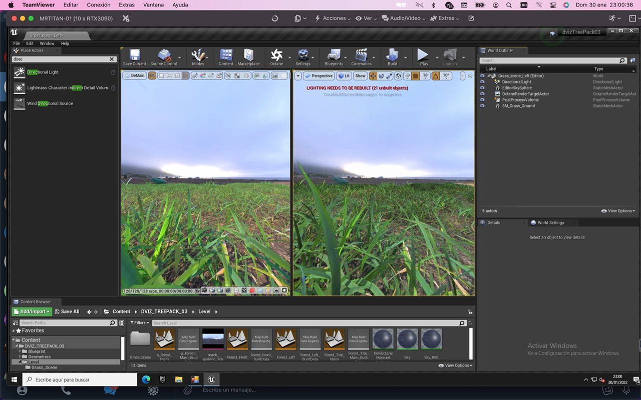

Hello, is there any plan to support landscape brush and instancing anytime soon.
If it is supported, haven't been successful to find the way.
Thanks for creating great software!!

mrfactory wrote:Hello, is there any plan to support landscape brush and instancing anytime soon.
Best Regards
That is odd. Instancing/Foliage is supported and is showing up in my test scenes.
Could you send me your scene so I can figure out what is going wrong?

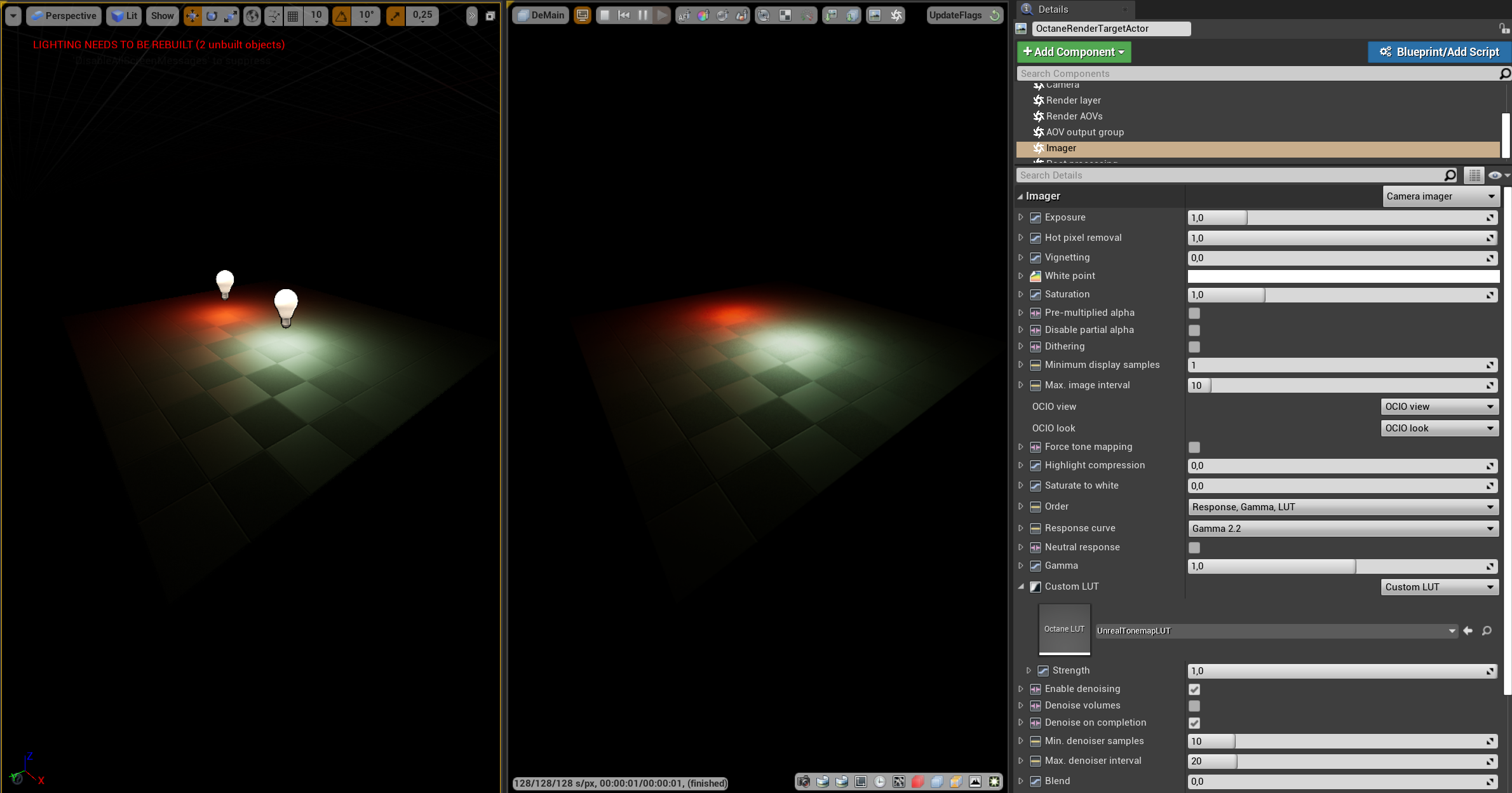

mrfactory wrote:Hello, there is a color difference in 4.27 between Octane Viewport and UE4 viewport.
Questions:
Best Regards
The problem here are the sunsky systems, not the color system.
Unreals synsky system gives a slight blue tint to the scene, while octane gives a slight pink/reddish tint to the scene
I am not familiar with ocio mystelf, but I believe you need to set the ocio from inside the Octane GUI preference menu.
The octane plugin strives to duplicate color inputs correctly, however the unreal tonemapper and the Octane imager create differences in results.
Effectively, we try to aim to keep the results between the unreal "Post tonemap HDR color" buffer visualisation in unreal, and the default octane imager the same.
If you want to reproduce the default unreal tonemapper you can use the following settings: (turn off eye adaption though)

Thanks so much for your fast answer. Sry for the delay in answering. Tested and foliage works perfectly.
Best Regards
Scene created using Octane Render plugin as a Ground Truth
Instanced foliage tested. Baking grass with UE4 is almost impossible, would take AGES. Can't wait for Brigade.
