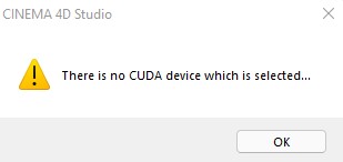

I meet a problem : Octane don't work on a new PC on Windows 11 with a GeForce RTX 3090.
I have installed the 2019.1.5-R3 Octane version because it was the last version i work with on my last project.
This version is it compatible with RTX 3090?

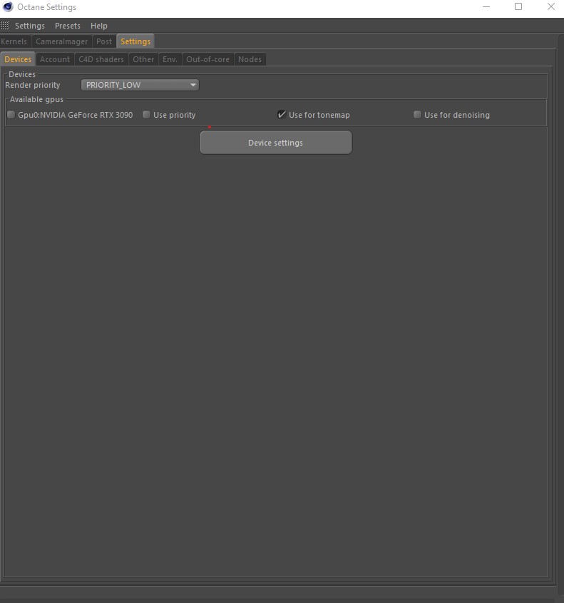

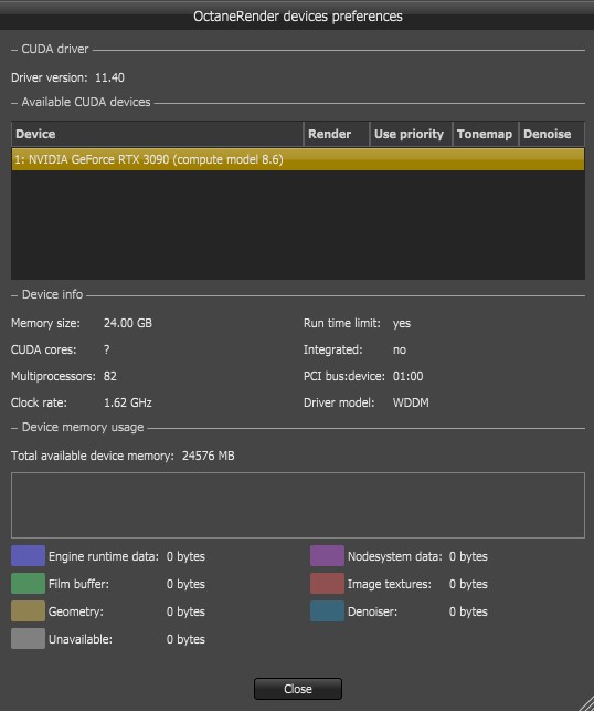

I post screenshots.
Is it a driver problem?
Is anyone to help me please?
Thank you in advance for your help

it is not an Nvidia driver issue, but an issue of OctaneRender SDK version.
Ampere RTX 30X0 first support has been added in OctaneRender 2020.1.5 SDK, but the AI Denoiser is not working, the full support has been added in OctaneRender 2020.2, so any other previous version cannot be used with Ampere GPUs.
