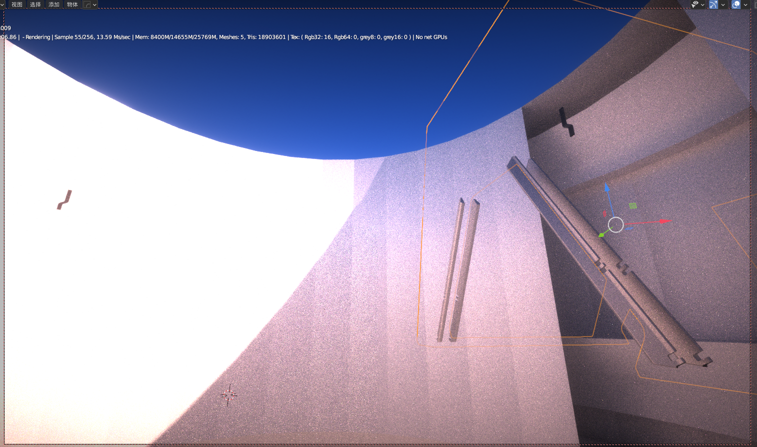

In editing, all objects are normal, but in the rendering window, most objects are lost, please check the picture I uploaded, you can see the problem, my configuration is 128G memory, the graphics card model is 3090
I don't know what happened ,please help me

Each object should be "reshapable proxy"?
Object Properties> Octane Settings> Object type
Your objects may be "scatter...."
linograndiotoy
Posts: 1524
Are you sure your objects are active for both preview and render in the Outliner?
