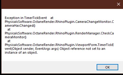

Ive been having octane and rhino crash a fair bit lately.
ive loaded the latest update but still getting a variety of messages as below.
This comes up and i cant even open a file i was working on in the previous version an hour ago.
Sometimes it crashes without any messages.
Any help would be awesome.
cheers
Tim

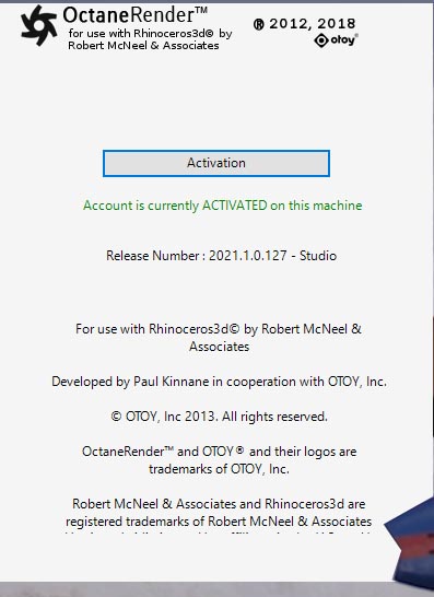

Can you tell me exactly which version of the plugin you have installed please?
Hi Paul,
thanks for the quick reply.

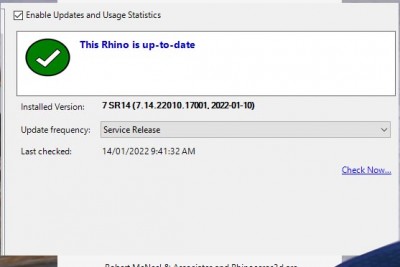

octane and rhino version info below. Ill send you the files now.
Sometimes they crash when trying to render but they can also just shut down when I try to open.

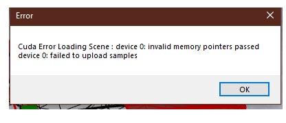

tried again this morning.
loads but wont r
ender without this warning
