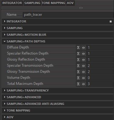

The equivalent in Clarisse is:
It says "Sampling > Path Depth" but it is not directly about sampling and instead, defines the maximum depth bounces of a given path (diffuse, reflection/refraction, volume/SSS, etc). For instance, a value of zero for diffuse is equal to disabling diffuse illumination. Therefore, increasing it will add more "bounced light" to the scene.
These values should be at minimum 2 or 3 for plausible results. Some scenes may require the value to be higher e.g. 10 or more. It is also scene dependent.

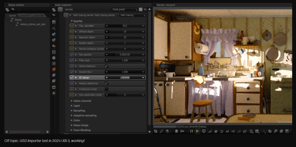

haffy wrote:Regarding your very nice manual, guide. The "GI Clamping" section seems to be missing some image or video, showing the differenses. Would love to see this, as I think I may be using this wrong too.
I've been told about this issue yesterday!
It seems to be a bug/issue only on chromium based web browsers (Chrome, Brave, etc). It does work as expected in, for instance, Mozilla Firefox:
