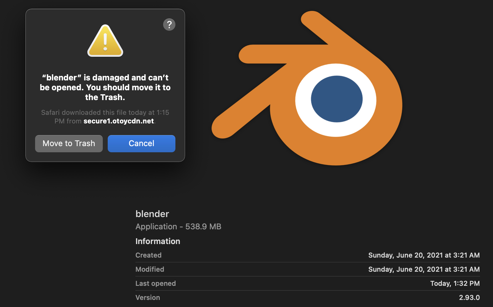

It appears the current "Octane X PR13 (Monterey) Blender for OctaneRender Installer" downloadable package is broken or incomplete and wont run the installer.
I attempted to download it a few times under different browsers and get the same result every time.

Ok,
Found a solution.
1) Launch a Terminal window
2) Type: xattr -cr /Applications/Blender.app
3) Launch Blender.
4) Celebrate.
I'm not sure if the issue is on the OSX side where Monterey is being overly cautious with downloaded apps, or if the uploaded build provided by OTOY is not to spec in regards of how Apple approaches install files.
