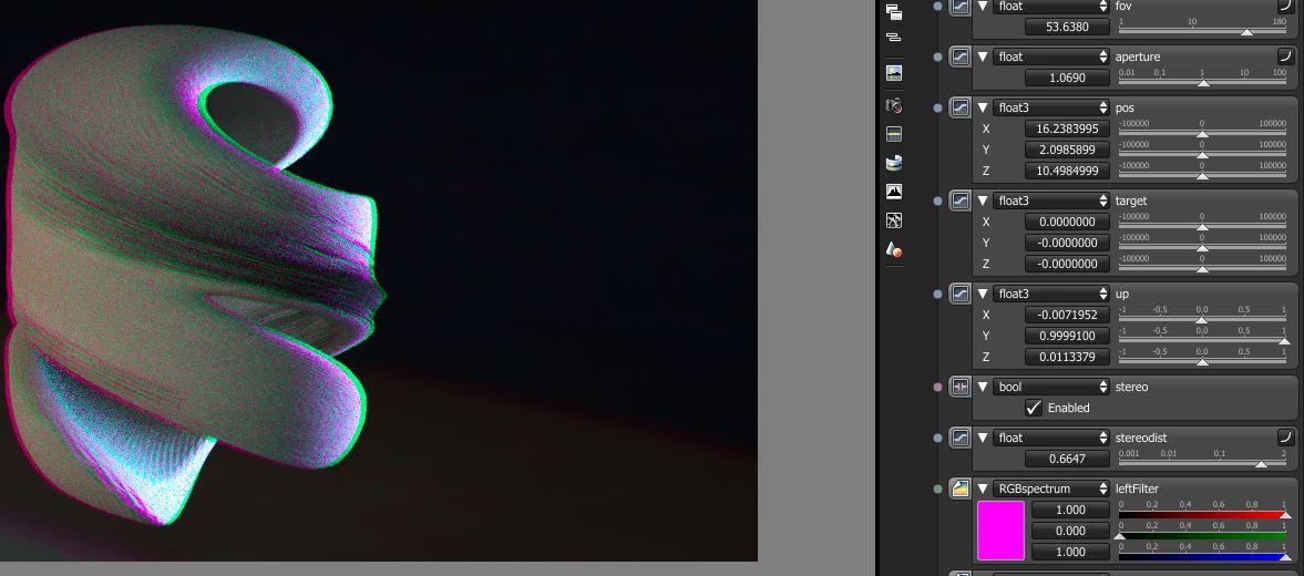

I meant that when i set up the scene in Octane, I set stereodist in thinlens node. Then when i render animation i get images with much larger distance between left and right eye. I see now that the value stays the same, but results differ.

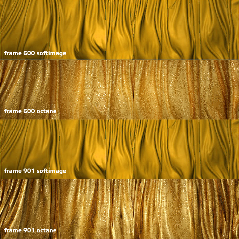

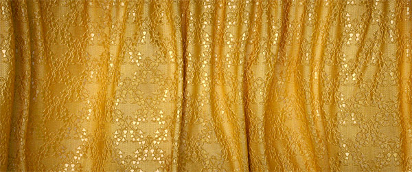

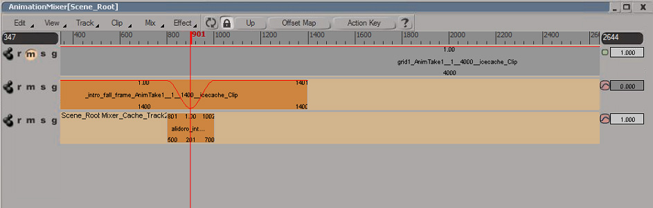

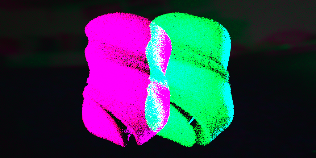

Hello, again. Normals still not perfect (but better).
Here is an illustration. I need to make a loop, in softimage frames are equal.
Rendered using 2.49 release.
Alternative octane exporter works fine with it, but crashes too much due to memory.

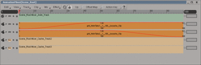

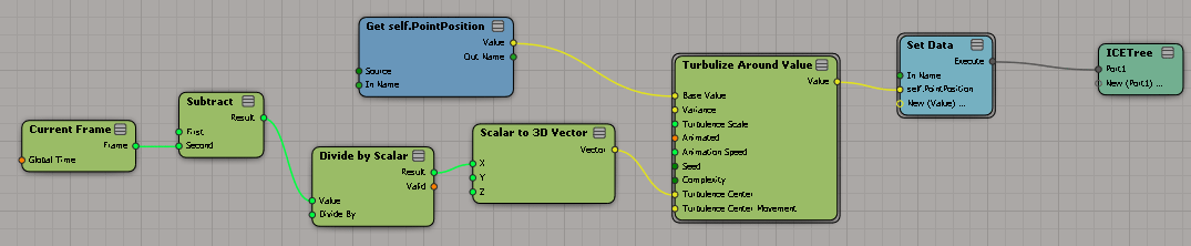

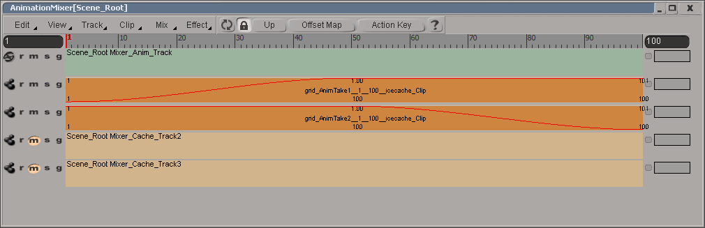

Have test it with a turbulized deformed grid with an animated center.
In the first cached ice tree, the center moves from left to right, on the second i have added a subtract so that the turbulized center moved from right to left.
The animation is 100 frames long. I blend between the two cached data like the image.
I don´t see any difference between an animated and an unanimated export. The booth seams to be the same.
I have load the exported meshes in Modo and have delete the surface normals. The result is, that the normal calculation in Modo is the same as the exported ones.
I have also export the deformed mesh with the Softimage standard obj export. And again, the result is the same.
If i reimport the exported meshes, the animated, unanimated from the plugin and the Softimage standard obj-export back in Softimage, they looks the same as the original.
I don´t know who the error can lie.
Maybe you can send me the zipped scene/mesh or a linke where i can download it?
