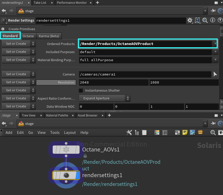

BK
Posts: 1567
eyeonestudio wrote:What is the correct 2021.1 Denoiser usage?
-Edit Camera Ndode > Imager > activate Denoiser.
-Viewport > Viewing Out icon > ?
search.php?keywords=denoiser&t=75948&sf=msgonly
Hey eyeonestudio,
yeah! we need a camera and render setting node in the downstream
- then Octane tab>Imager>Activate the Denoiser
- And add Octane AOV node (under digital asset) and enable the Denoiser AOV
- In RenderSettings node we need to add OctaneAOV render product
- Render octane on the viewport and pick the denoiser pass and that's it!
If you have any feedback on workflow, please feel free to let us know!
cheers
Kind Regards
bk3d
