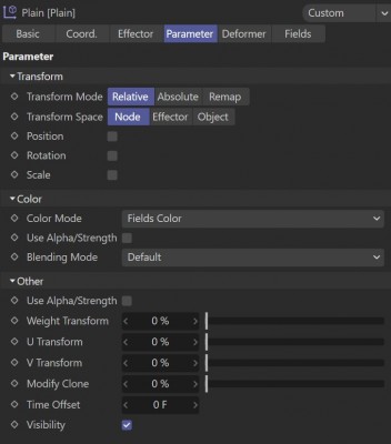

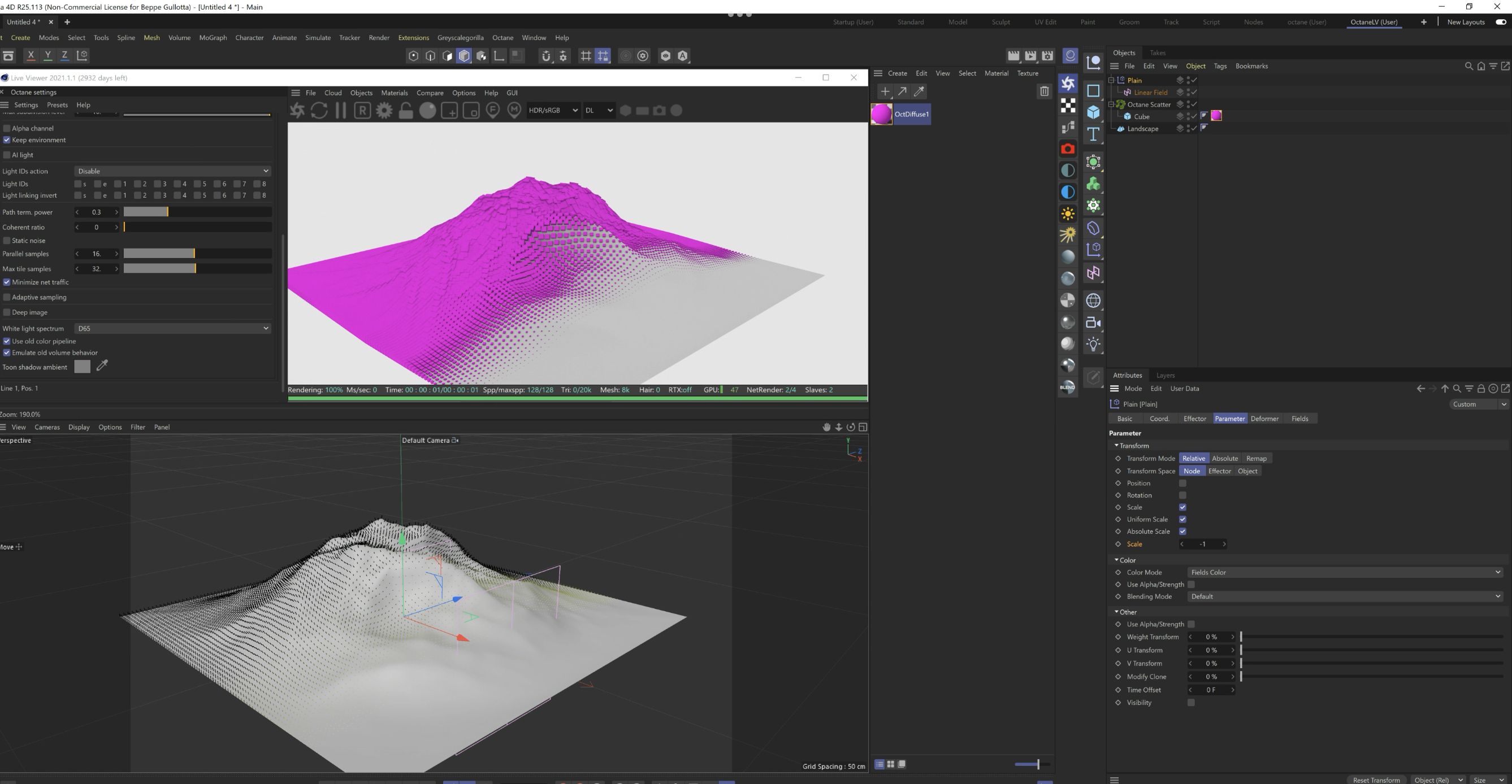

I need to clip Octane Scattering result by using Plain Effector's visibility feature but it does not effect. Where is the problem here?

Yes, it completly ignore visibility on all effectors. I don't remember if it worked in earlier versions.
