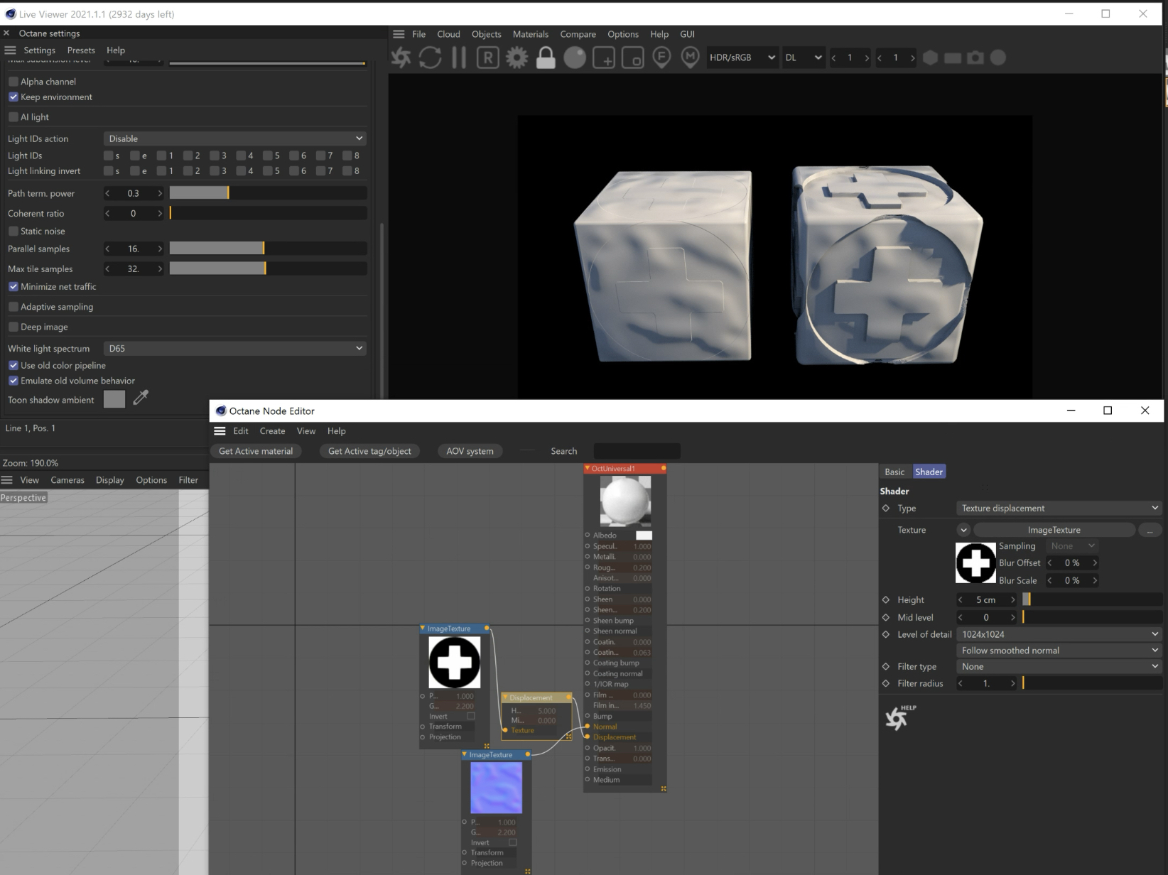

Or did something change? I can get vertex displacement working fine, but texture displacement shows no displacement no matter the displacement map / settings in the displacement node.

Please, upgrade to 2021.1.1 new stable version.
You can find it by visiting your personal Downloads area:
https://render.otoy.com/account/download_archive.php
Texture Displacement is working as expected here:
