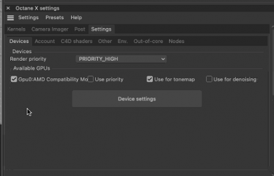

However, I encountered a new problem: the first rendering test is really very very long and I wonder if there is not an adjustment to be made at the level of Octane, I am sending you to locate the rendering times of a test scene on the following 2 configurations:
- Mac Pro 2009 High Sierra - Geforce 1080 8GB - C4D 18 - Octane 2019: 44 sec.
- Mac Mini M1 2020 8GB - C4D 22 - Octane X: rendering is not complete after 40 minutes!
I send you the screenshots of the settings on the Mac Mini: do you see anything to change?
I wish you a merry Christmas,
thanks a lot,
Julien

Octane is a GPU renderer. The Mac Mini is an amazing feat of engineering with never-seen-before CPU efficiency and offers great overall value, but it features an extremely lightweight GPU that is basically worthless for GPU 3d rendering.
Stick with your Geforce 1080
