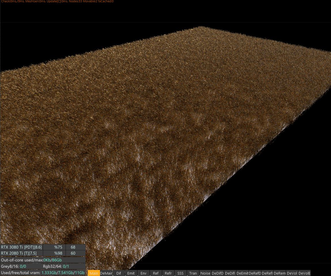

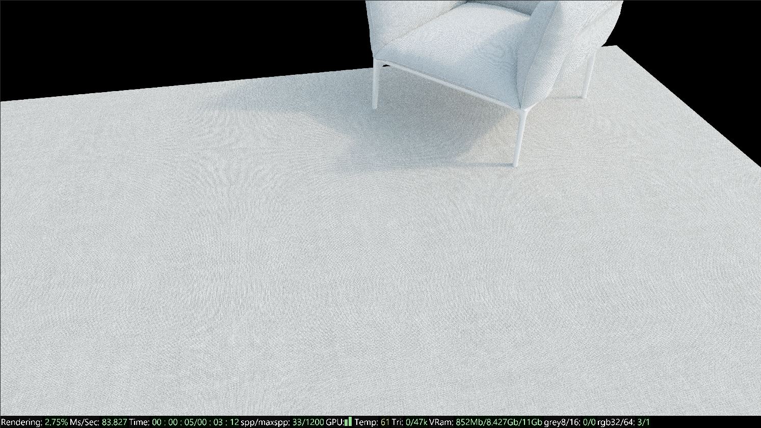

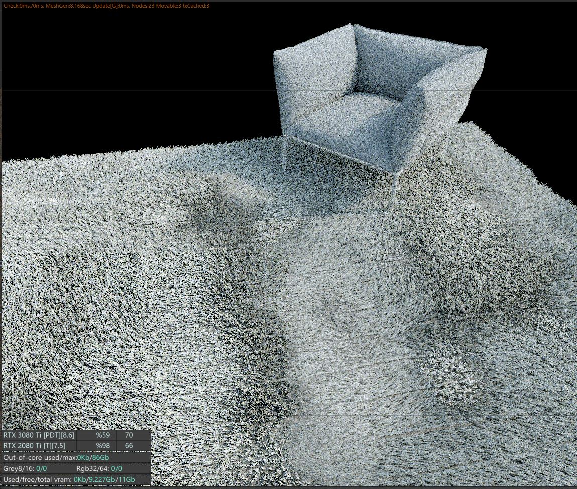

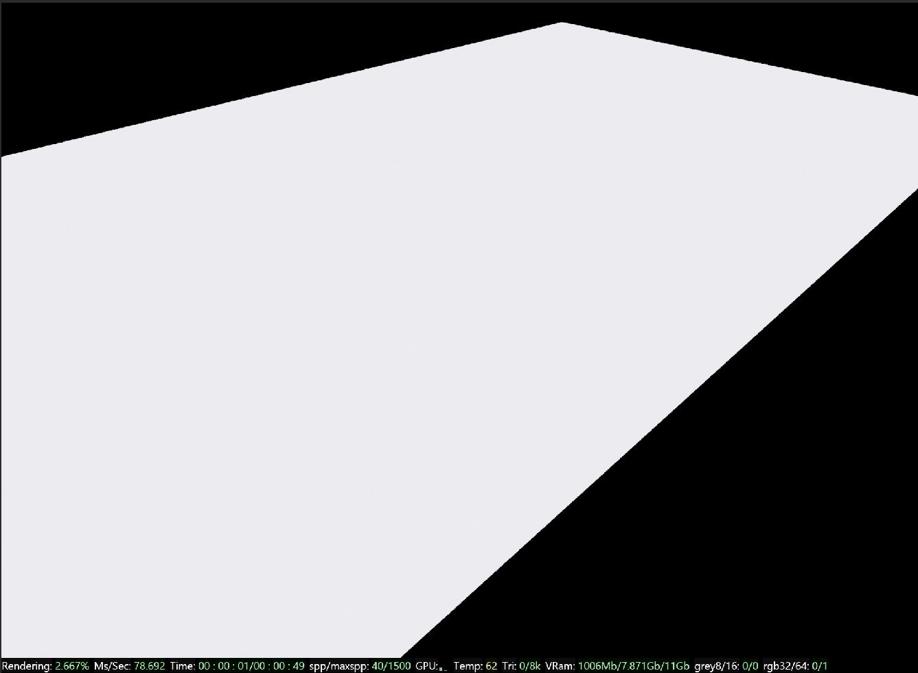

My Hair objects (carpets mostly) don't show up in my final render after updating to the new Octane 2021.
Ive uploaded my appoach to carptes with the old octane (pictures named old).
After understanding that there is a new hair-material and hair option in the object tag, i've set up a new approach, which also doesn't render in Picture Viewer.
Which is odd because both of them, old and new, render in Live Viewer.

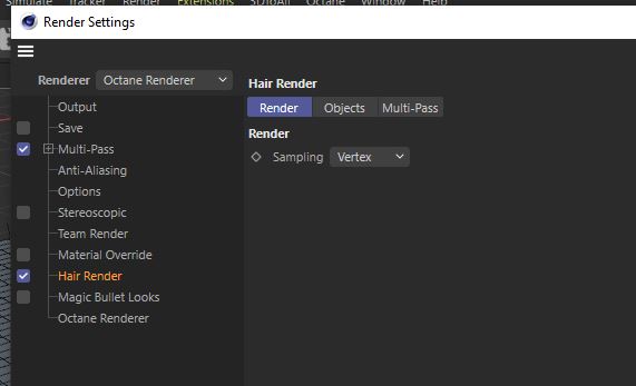

I've also played with the Hair options in the render options window, which appears now in Octane 2021, but i couldn't get a result that renders.
Screenshots are both made in R25 with the new Octane. The names "Old" and "New" just relate to my approach of doing hair.
