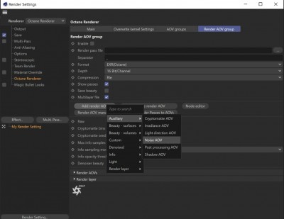

Hi, I´ve just updated to last plugin version (R4) and now i can not see the noise channe when using the adaptive sampling option. Is it now somewhere else i have to look for it, because it just used to pop up when the adaptive sampling was turned on. Not sure it is a bug.
Thank you!
Posts: 10597

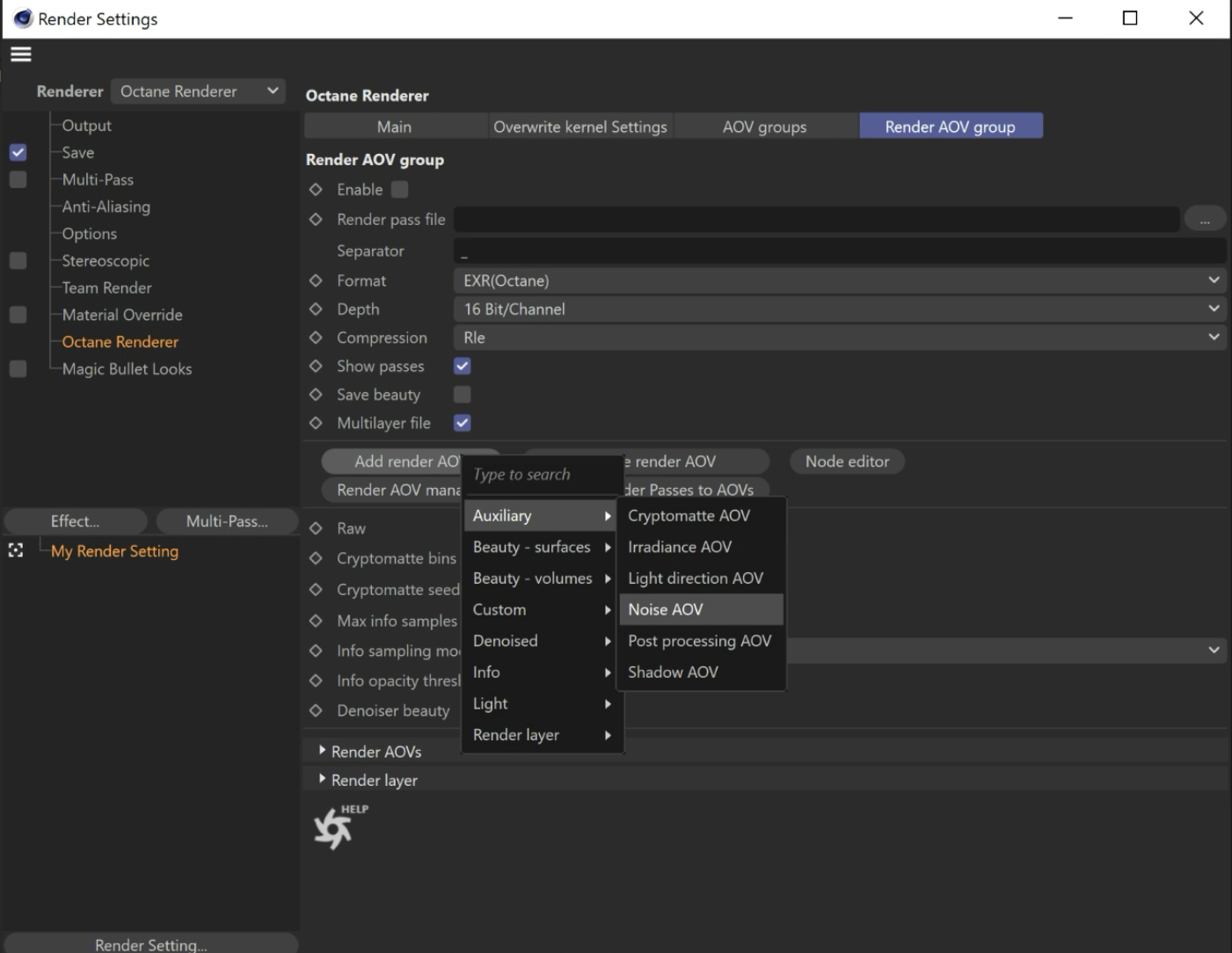

you need to go to render Settings/OctaneRender/Render AOV Group/Add render AOV/Auxiliary/Noise AOV:
And the Noise box will be available in Live View, even if the render AOV group is not enabled.
