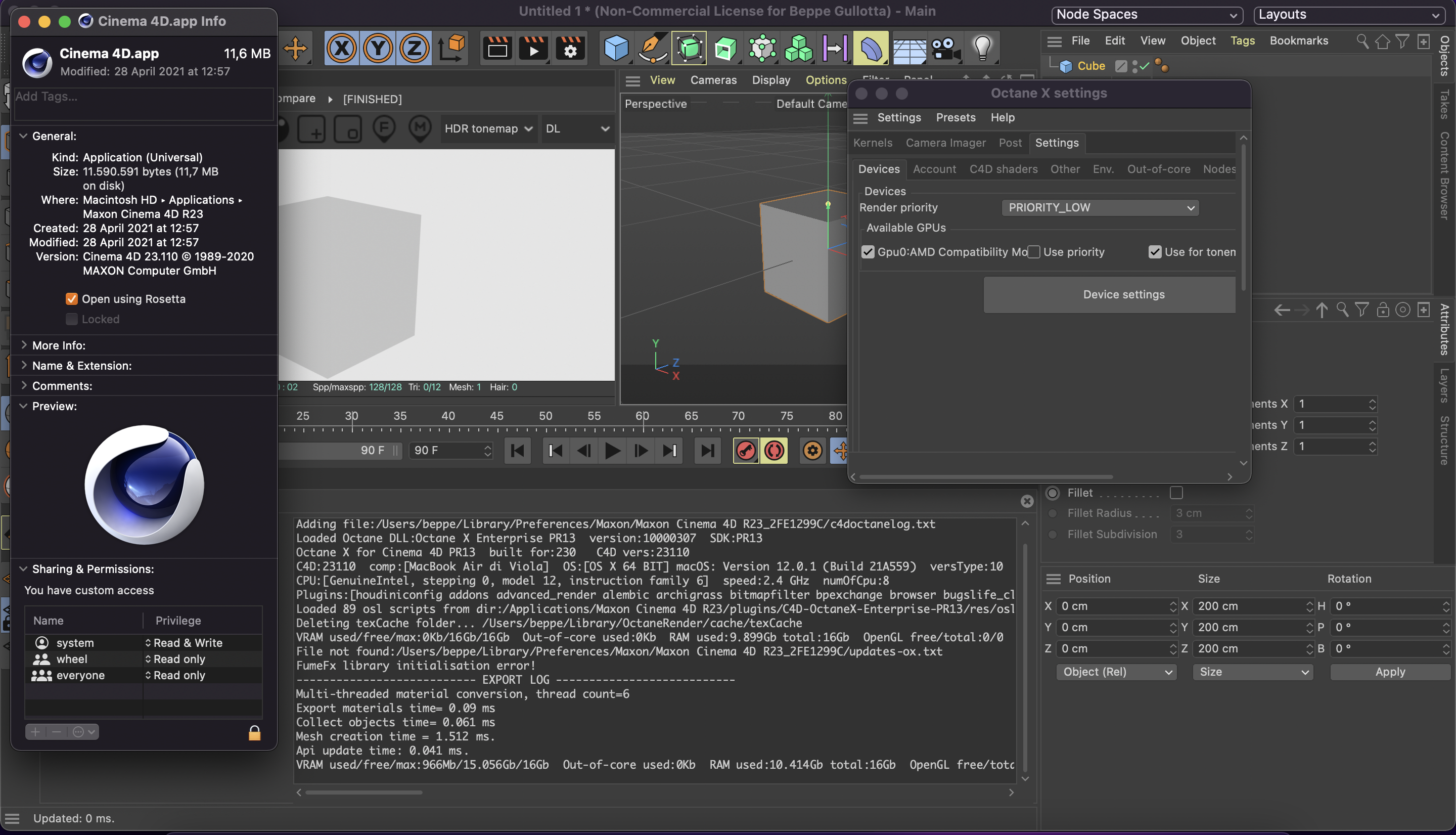

C4D-OctaneX-Studio-PR13 shows "There is no GPU device which is selected..." on M1MAX macOS12.0.1 C4DR23
Posts: 10598
it is working here, you need to enable Open with Rosetta option, and enable the GPU also for Tonemap, in c4doctane Settings/Devices panel:
