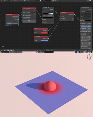

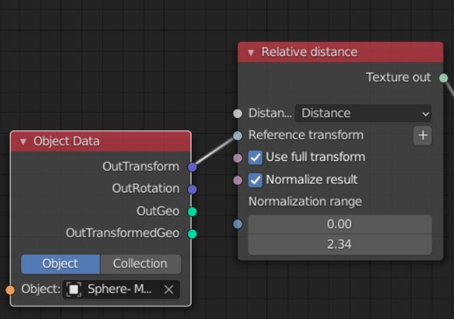

Hello, I think you can use the new relative node which was introduced in octane 2021.
It works fine in blender as you can refer objects location but I wonder how it can be done with C4D as there is no object data node in c4d or any way to refer location of an object in C4D.
Maybe Aoktar can shed some light on it
Relative Distance.blend
Octane 2021.1 Blend file
(9.35 MiB) Downloaded 180 times

aoktar wrote:All similar new nodes are combined under Custom Texture node. See it!
Yes, we have access to the relative distance node, but how do you reference an object's location into the transform?
like this
For example in perspective projection node in C4D we have option to add a camera, maybe something similar could be done here for the relative distance transform?
