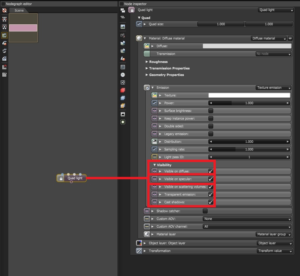

elsksa wrote:Hi,
If the scene has properly been modeled at-scale and the shading is plausible, changing the size of the lights should not be necessary.
To answer your question, I have shared a screenshot, below, from Octane Standalone (which I exclusively use). Does Octane for Unreal Engine has these Visibility options?
Hi Elsksa,
I'm afraid I don't use the standalone Octane version and I don't see this option in the plugin as I'm using native unreal lights.
Love the software and how much work is being put into compatability.
