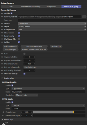

For me it looks like a bug, but maybe I'm doing something wrong?
After an image finished rendering in EXR(Octane) format the file is not written to folder.
If I change format to any other including regular EXR everything works as expected. The passes which I render are not stored only for the EXR(Octane). At the same time, the correspondent folders (for different passes) are created successfully.
I tried it with Octane versions 2021.1 and 2021.1-(R2). The same behaviour in both cases.
PC's tech specs a listed in my signature.
I would like to use Cryptomatte, so there is no option for me to switch to another format. Please, help.
Here are my render settings:

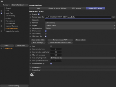

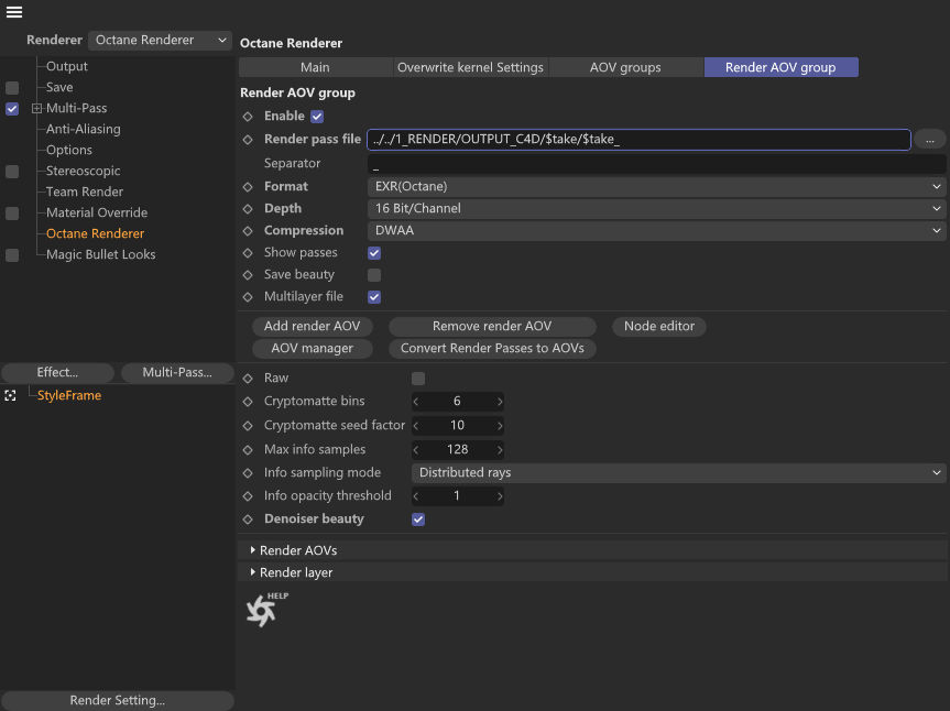

Have you tried simple paths without $take/etc..?

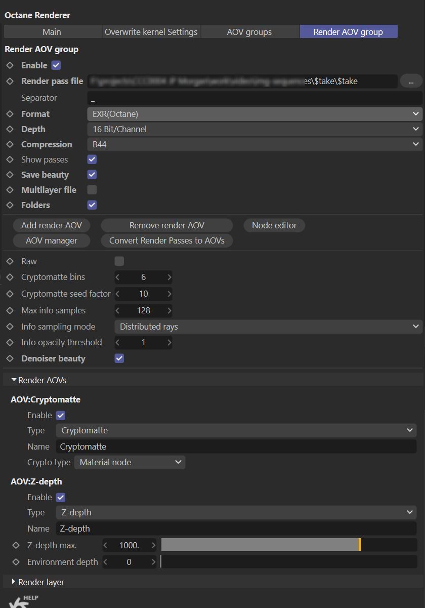

...and realized that I have a space symbol in one of the folder names (in that part of path which is blurred in the screenshot).
So it looks like a bug, because it never happened with any previous versions of Octane (using spaces in folder names for years, as well as Octane).

Here is the first problematic part of the path: F:\projects\ССС0004 JP Morgan\
(F is an external SSD, if it matters).
