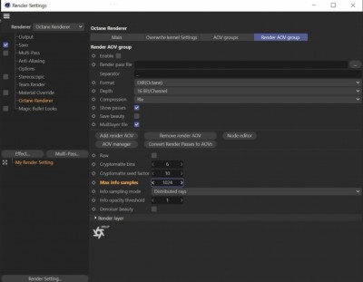

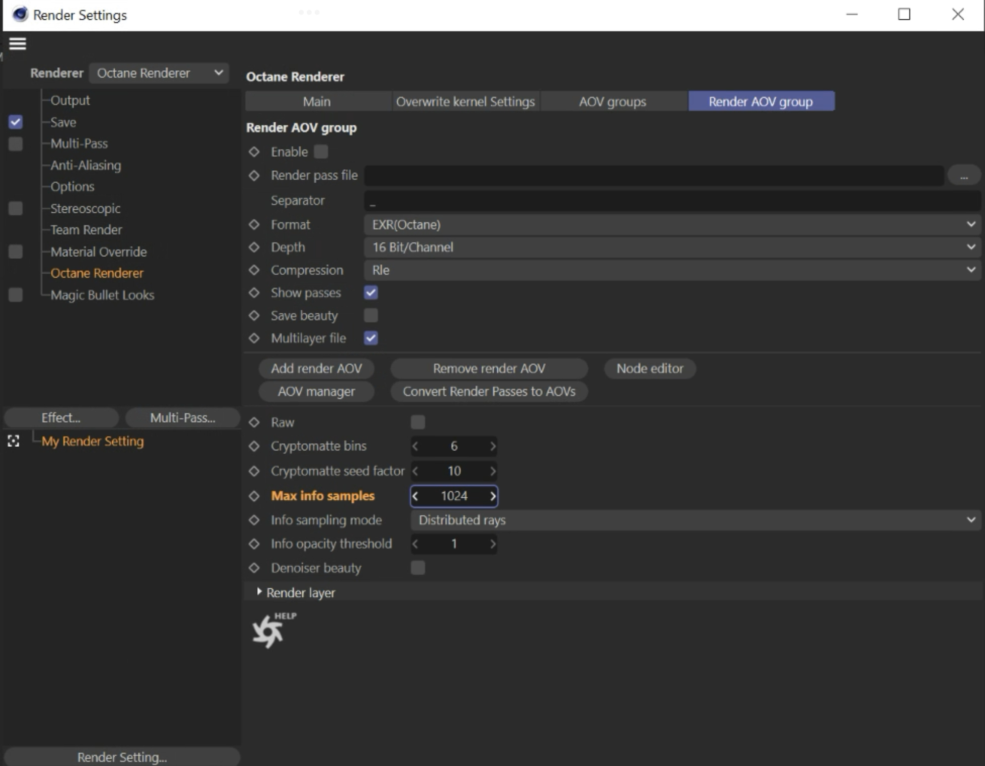

I am rendering a scene with decent depth of field and i want to render cryptomattes and object layer color. Whenever I do so, my OLC comes out noisy and my crptomattes come in mostly black/wrong. When I turn the DOF completely off, the renders work as they should. What are my options?
Thanks!
Posts: 10613
maybe 128 samples are not enough, try to increase the Max info samples value to 1024:
