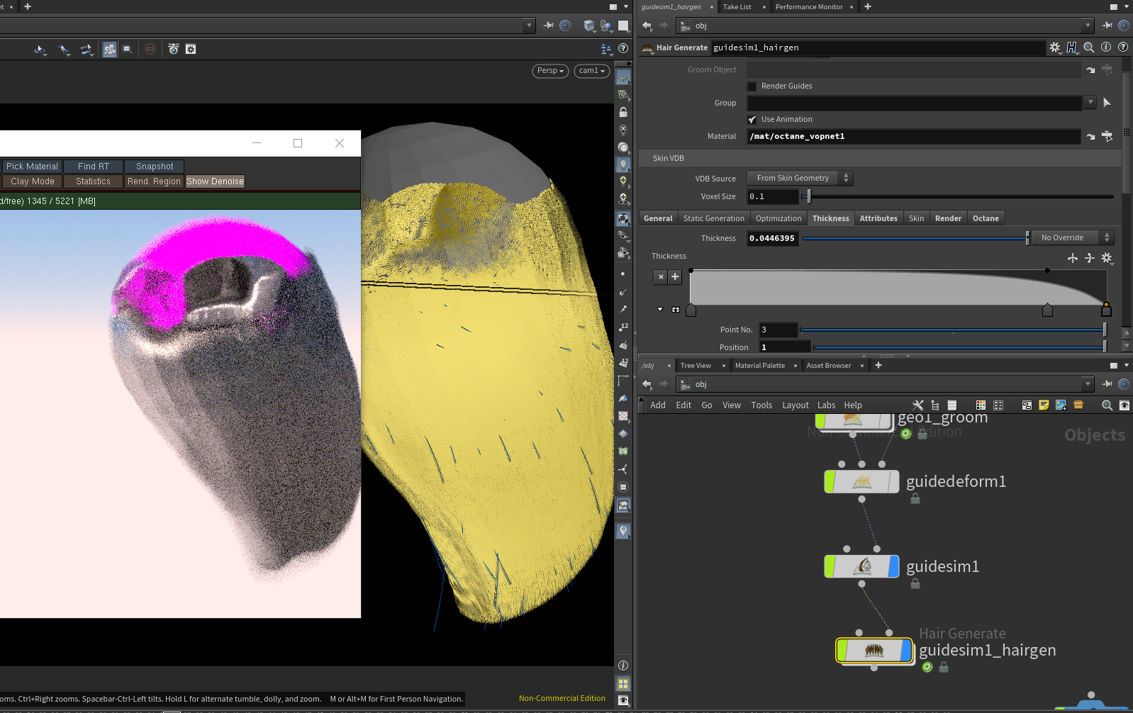

I have managed to get hair motion blur working but as I increase motion blur amount from 0 - 0.5 the motion blur is visible on the hairs but almost half of the hair disappears ( underlaying object becomes visible instead).

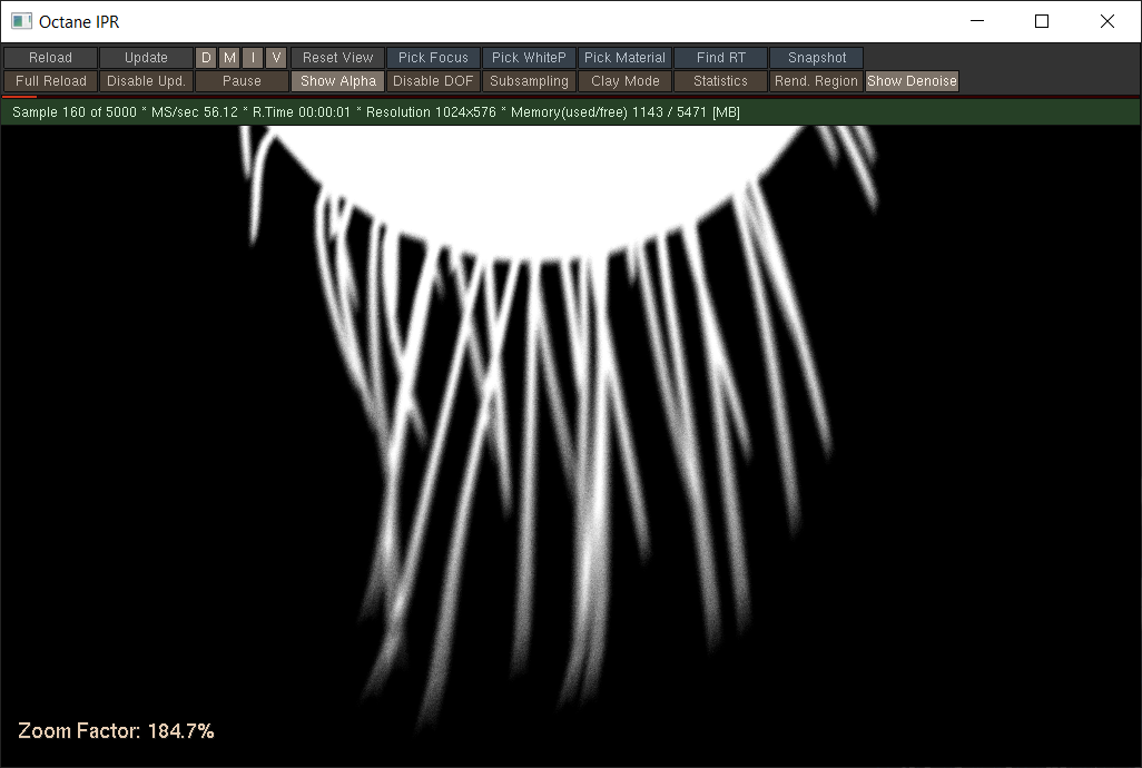

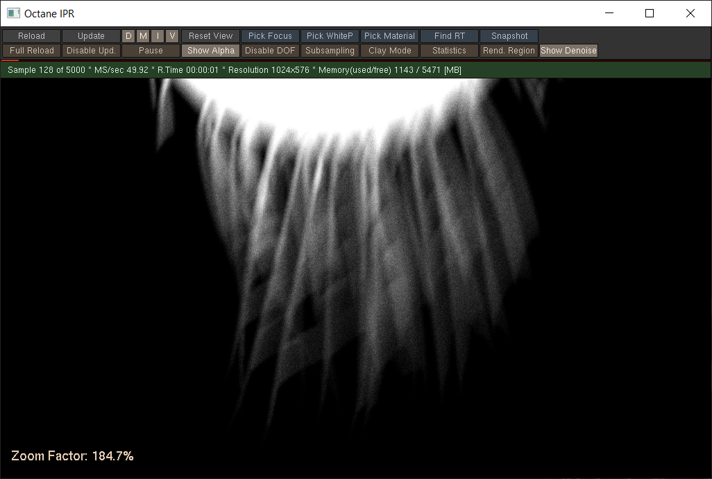

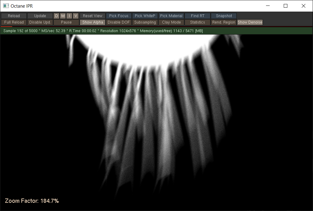

juanjgon
Posts: 8867
Location: Spain
Yep, something is broken. Check what happens when you raise the shutter time. I'll report it to the core devs.
Thanks,
-Juanjo
juanjgon
Posts: 8867
Location: Spain
Quick update: There is indeed a problem with the hair motion blur rendering. The core team will try to resolve it as soon as possible.
