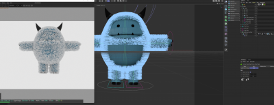

Hello! After I rigged my character I added a vertex map for hair.
Octane doesn't recognize the vertex map unless I deactivate the skin tag. Is there any way around this?
2021.1-R2, 3080RTX, WIN 11

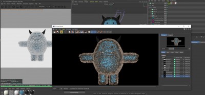

Thanks for looking into it! Here is the file
https://drive.google.com/file/d/1x8Jaut ... sp=sharing
If I disable the skin tag, Octane will render the hair just fine.
Posts: 16068
Location: Türkiye
Have you checked with C4D's renderers? They are giving similar results. Otherwise that would be surprisingly weird.
