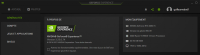

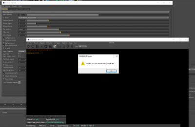

Hello,

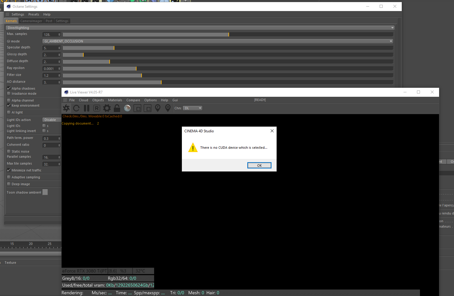

I install octane render standalone and the plugin 4.05-R7 for c4d R19 on My new computer.

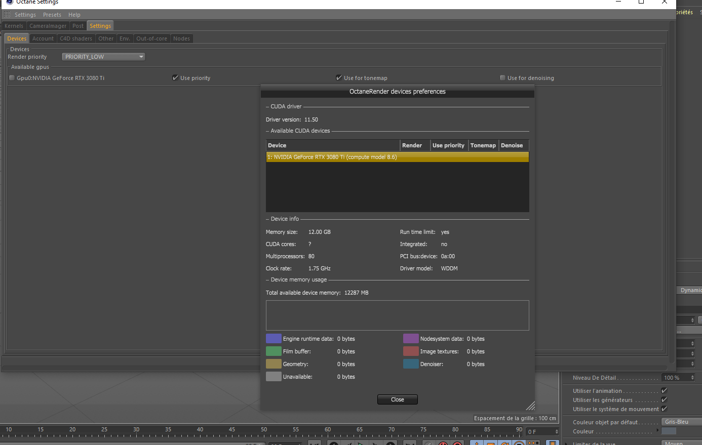

i have a message " there is no CUDA device which is selected " and if i try to check the box on. It doesnt works why ???

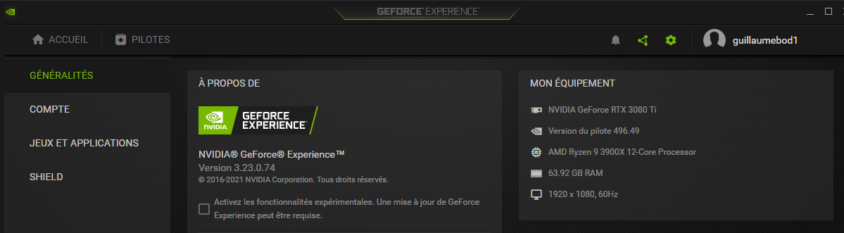

I have a RTX 3080 Ti.
Thank you for help
WATCH MY SCREENSHOTS

OCTANE 4.05-R7 NOT WORK WITH A 3080 TI ??????
Please answer
Posts: 10611
The support to Ampere RTX 30X0 GPUs has been added in 2020.2 SDK, so any previous version cannot work:
viewtopic.php?f=24&t=76901
