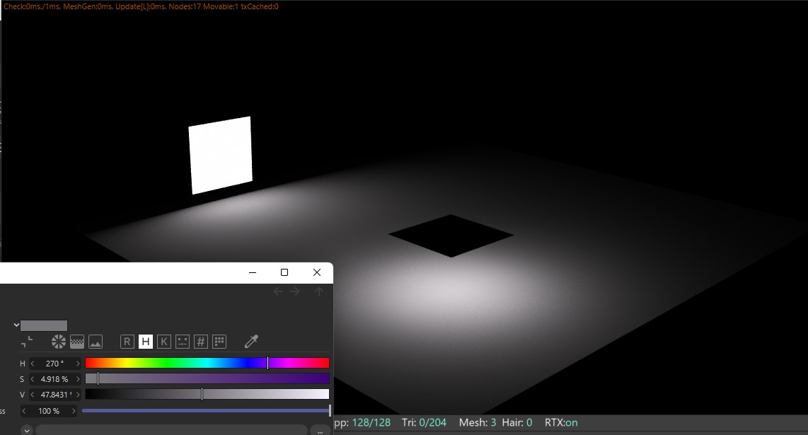

For reference, this is what we get with a white material and a default octane light, a good 10% blue saturated surface (the material view is just there to show what colour the image is rendering as, the actual octane material on the plane is white):

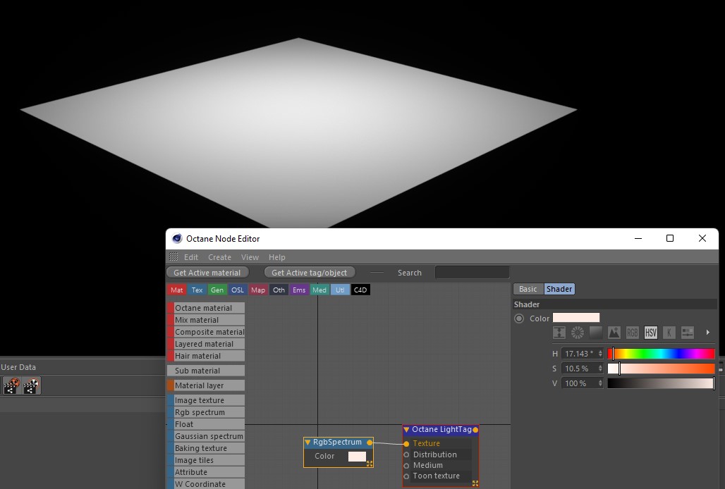

The simplest way we have found to combat this is to insert a simple octane rgb spectrum of pink into every light, these then render out with neutral greys and whites.

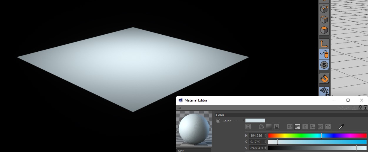

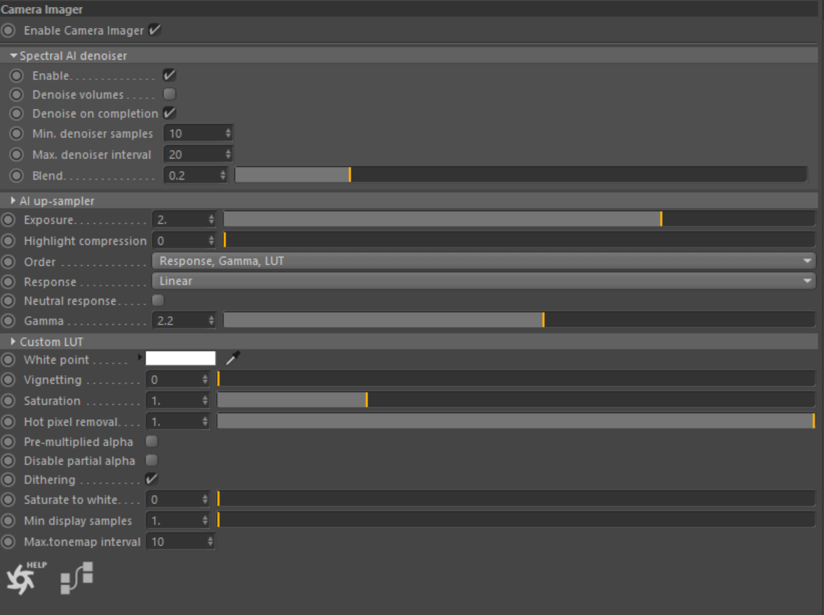

There is a WB Option within the camera imager (like in the real world, you would set the WB in your camera, not in your lights, and I know what I am talking about because I am also working as a professional advertisment photographer for 13 years now, where color trueness is an important factor) but you have to sample the grey-point on the right spot. Like you did when measuring Light-tempartur with an good old Lightometer. Not just clicking on any neutral colored object within your scene.
Just a ntk-fact: The 6500 Kelvin light temperature is truly a thing we can fight over, because high-class quality studio lights have an estimated Kelvin temperature around 5550 Kelvin, which is almost "pure white" light.
But in the real world, you also have slightly variations due to the fabrics you put on for diffusion. Therefore, you have to tweak you WB in-camera. Like in octane.
See attached photo for the WB option inside the camera imager tab within your octane camera tag (pretty sure you know about it, as you described it, but for anyone who looks at the same problem, and doesn't know where this function is.
Hope that helps.

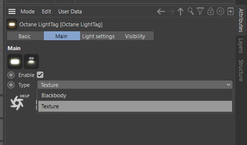

I'm not sure if I'm misenterpreting something, but I believe the solution is, as mentioned, to just switch from Blackbody to Texture Emission in the light settings.
See attached C4D file which is an adjusted version of the file posted above, and a screen shot of Octane Light Tag settings.

Thankyou! truly, thankyou, this is what we were missing. Universally in c4d all the useful settings always start on the third tab of attribute settings, we were skimming over this 'main' tab the same way that you automatically skim past banner adverts on webpages, or cant find the butter in the fridge despite it being at the front of the middle shelf.I'm not sure if I'm misenterpreting something, but I believe the solution is, as mentioned, to just switch from Blackbody to Texture Emission in the light settings.
We were under the impression that octane being a spectral renderer meant that setting a white balance for the light was mandatory for all lights
