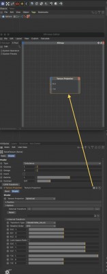

Trying to figuring out if there is a way to animate Octane noise texture projection using sound effector with xpresso. Attached my texture node if it helps to help me : )
would appreciate any help on this subject
thanks!
Posts: 10611

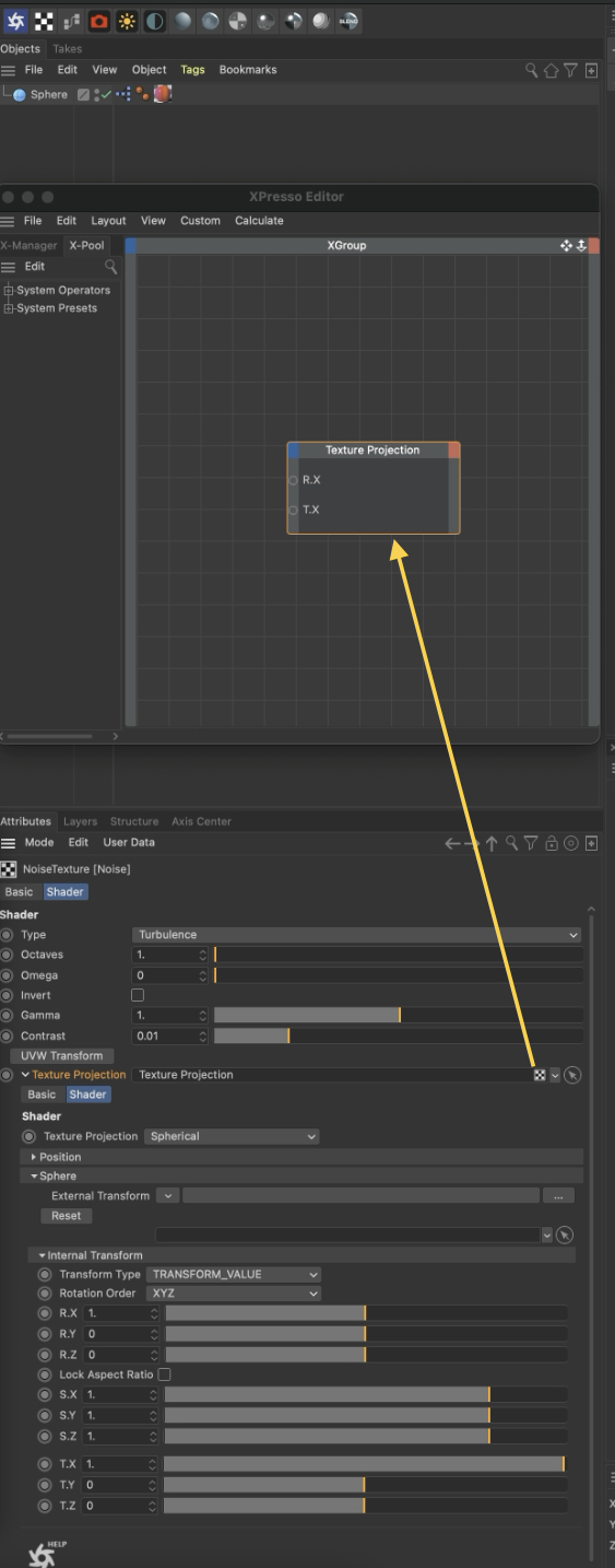

the trick is to drag & drop the texture projection node from attribute editor into the xpresso panel:

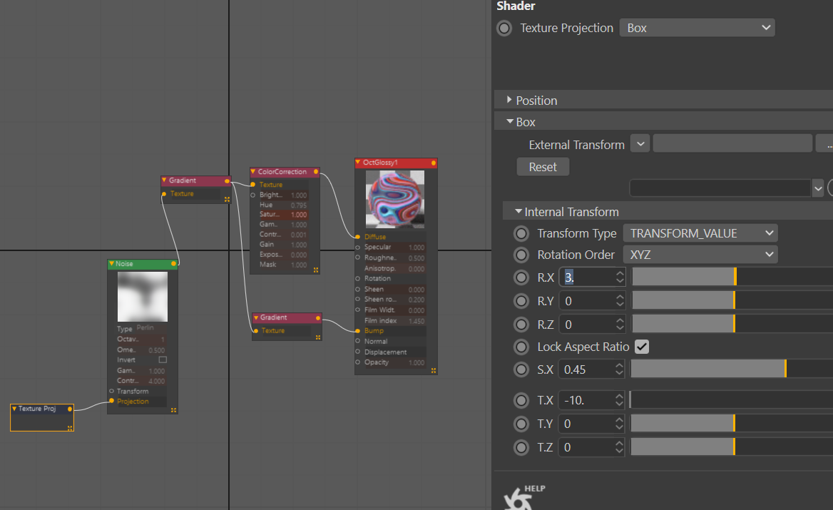

Thanks alot! for the reply. I did that but then how am I going to connect the sound effector? with object option? or?
I did like this but didn't work, Sound effector ( object) connected --> to Sample then to -->texture projection
