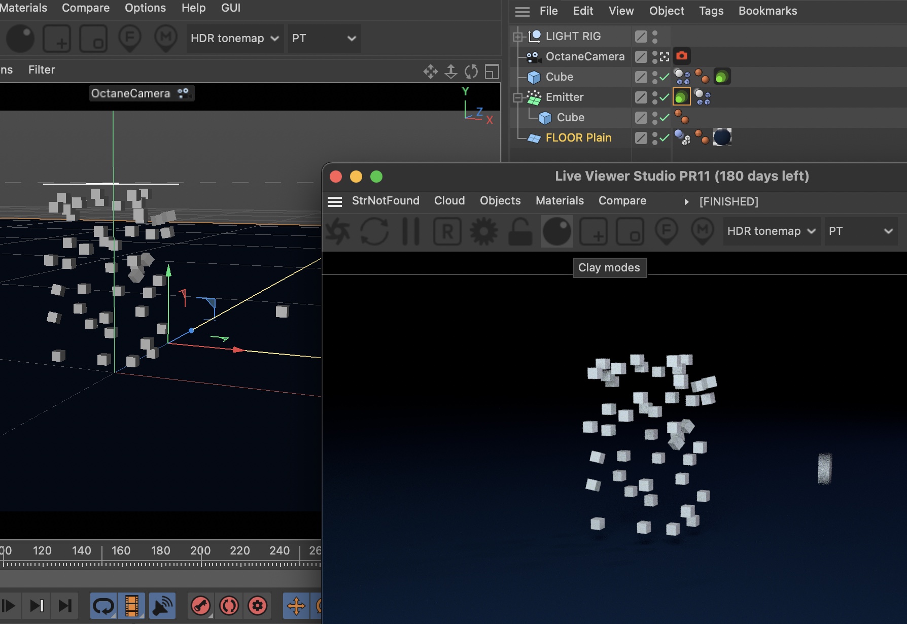

Just wondering how I get motion blur to work on an emitter, any clues?

First you should check it in PV. You'll see mblur if something is giving proper data as particleID and matrices.

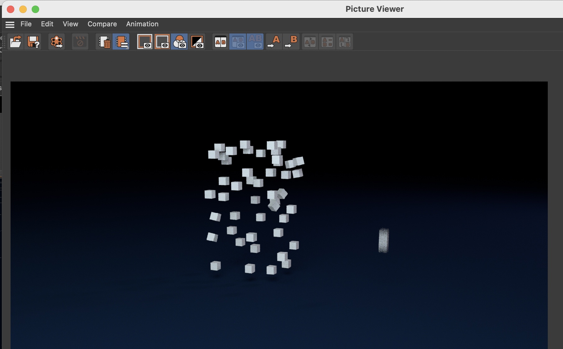

Oh Picture Viewer? Same result:

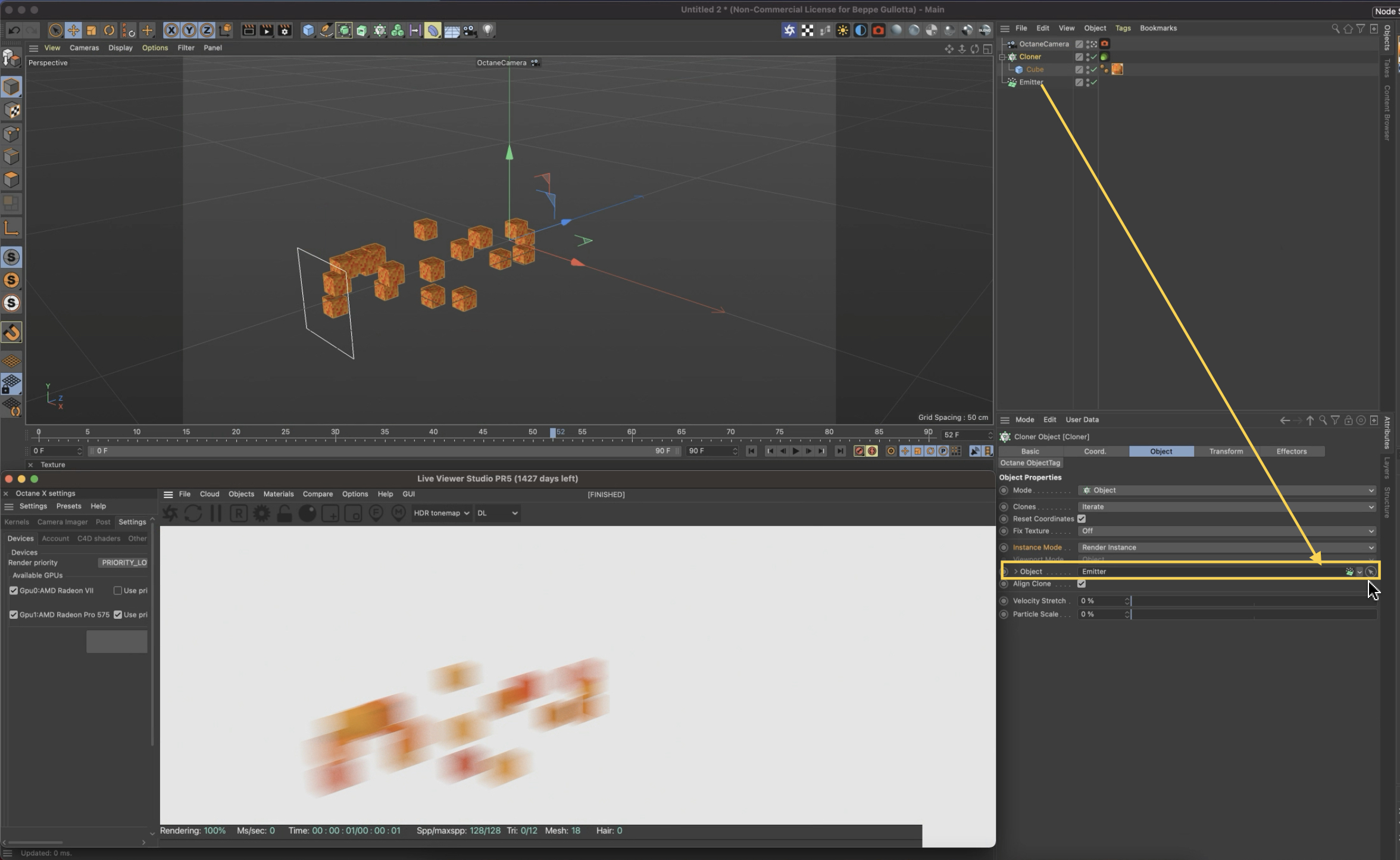

with stander c4d Emitter, you need to use a MoGraph Cloner in Object mode, with the Emitter as a source, and Render Instance option enabled:

boom that worked. Thanks Beppe
