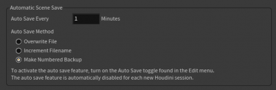

I keep having my renders to disk crash Houdini (even if I disable file output). This happens at random moments in the render and goes away when I disable autosave. (I do have a little script that enables autosave when I start Houdini).

C:/Users/Dominik/Documents/houdini19.0/scripts/456.cmd (1): Warning: autosave not supported by this application
This didn't used to happen on 18.5. Anything you can do or anything you would suggest to do on my end?

A few weeks later and I am still encountering those issues. If autosave is enabled it crashes the render every time (at least if it is enabled at launch with the scripts). Can't help but think it's because octane is somehow retriggering the launch scripts on render start...
Other than that I am getting a decent bit of render crashing when having autosave off.
