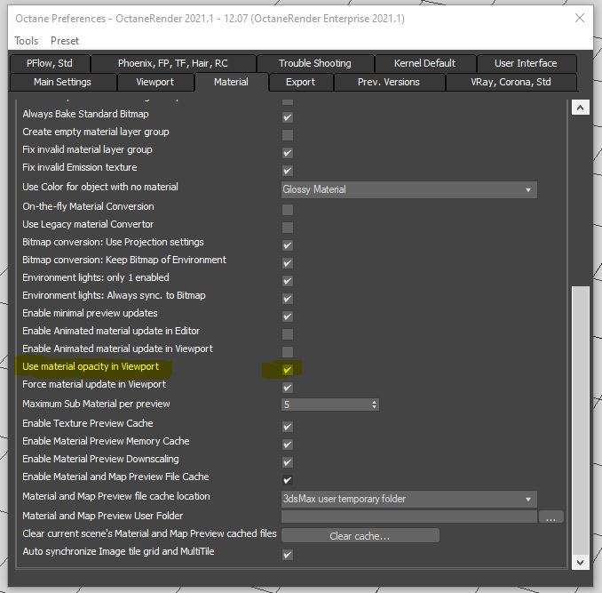

Use material opacity in viewport
HHbomb
Posts: 1435
What is this pref do ? and how to use ?
I see no effect checked or unchecked.
neonZorglub
Posts: 1100
HHbomb wrote:Hi,
Hi HHbomb,
When enabled, it uses the opacity value from the octane material when 3dsmax displays the object in the 3dsmax viewport.
(note that there should be a tooltip explaining this when you keep the mouse on the checkbox ;) - make sure tooltips are not disabled in the User interface tab )

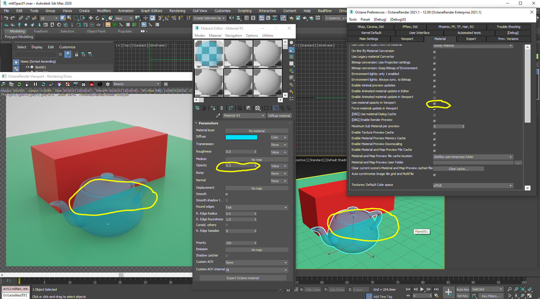

HHbomb
Posts: 1435
Hi NZ !
I wish you a happy holiday season.
Yes I can see the effect but I thought that it could be applied to texture opacity...
