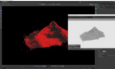

Hi All,
I have export an ABC simulation in houdini.
Imported in C4D thinking particles, All data are here. But i don't know how i can see this informations in octane. The instance color node seems line no working with the thinkings particles data.
I would like know if we have this kind of node in Octane : https://vimeo.com/393436800# (7min44)
The scene is here : https://drive.google.com/file/d/1noj-L9 ... sp=sharing
Thanks for your help
Best

You can get colors if you can connect it to a matrix or cloner object

Hi Aoktar,
Thanks, yes need to import Cloner in instance color node work well
Thanks lot
