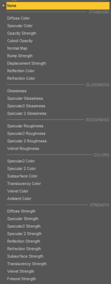

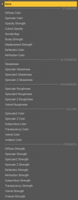

2) The templating system allows users to have RGB, RGBA and Float image nodes pull directly from the images assigned to the Daz surface. That base functionality is and always has been working. The problem is that there seems to be a hard-coded list of Daz surface parameters that you can choose to assign the image from (see screenshot below), and that list does not include a large majority of the parameters from the Iray Uber Shader (which is the most common shader used on Daz products for the last 4-5 years). I was not around for the early days of the Daz Octane plugin, but my suspicion is that this feature was implemented when 3Delight was the primary Daz render engine and never updated after they added Iray, so most of the parameters in the list are now obsolete.
In my opinion fixing this to at least include the Iray surface parameters is a bug and should be a higher priority to fix (especially if it's as simple as just updating the seemingly hard-coded list...). Additions to the templating system like being able to template the color I agree is more of a feature request.

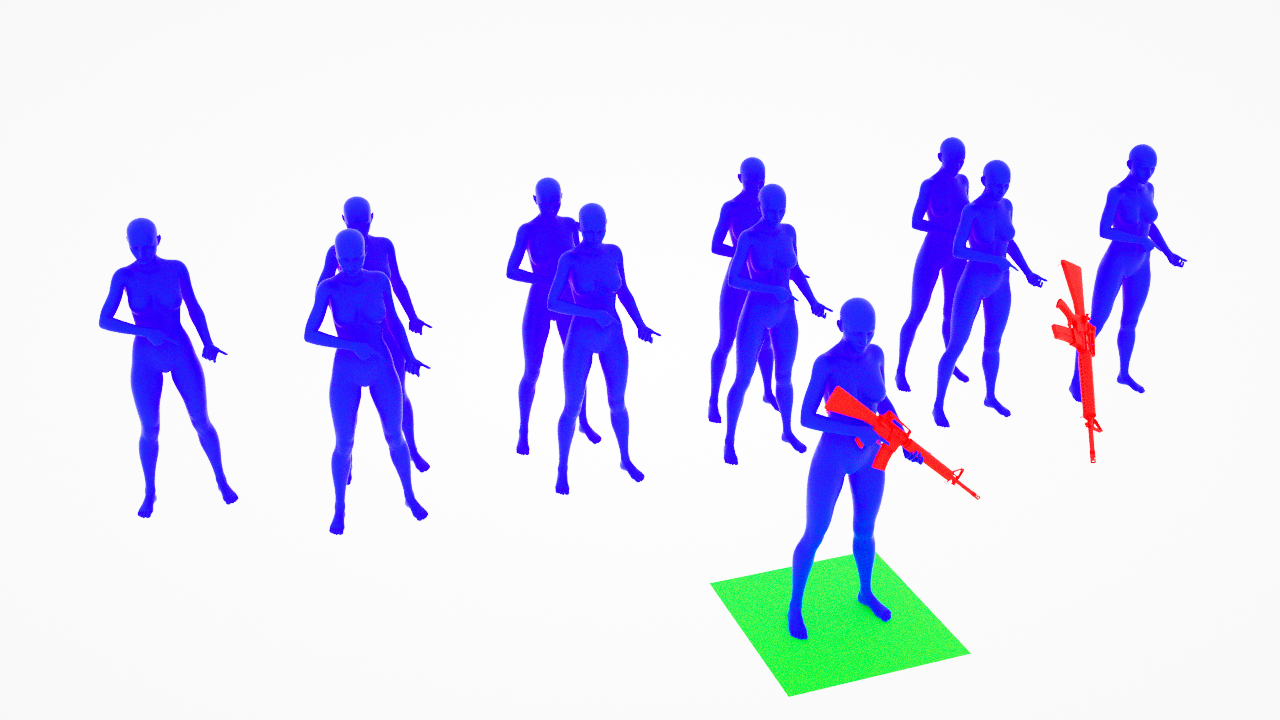

4) The plugin converts Daz instances to Octane scatter nodes. Overall, this is working very well and I use instancing frequently in my work, but it does have some issues - mainly when instancing parented figures and/or props.
The image below shows an example of this. I have a Genesis 8 figure with a gun parented to her right hand (the one standing on the green square). I then created 10 instances of her. The character instanced properly, but the gun she was holding did not - all 10 instances of the gun are in the exact same position randomly suspended in mid air off to the right. You can workaround this by un-parenting the gun from the character and instancing it separately, but this isn't an ideal workflow because if I decide later to change the pose or move her arms in any way, the gun will no longer move with her hand.
I can provide a scene file if that would be helpful as well, but I would say #1 and #2 issues are higher priority than this, as instancing/scattering is working very well outside of parented items.
