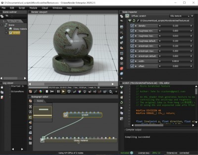

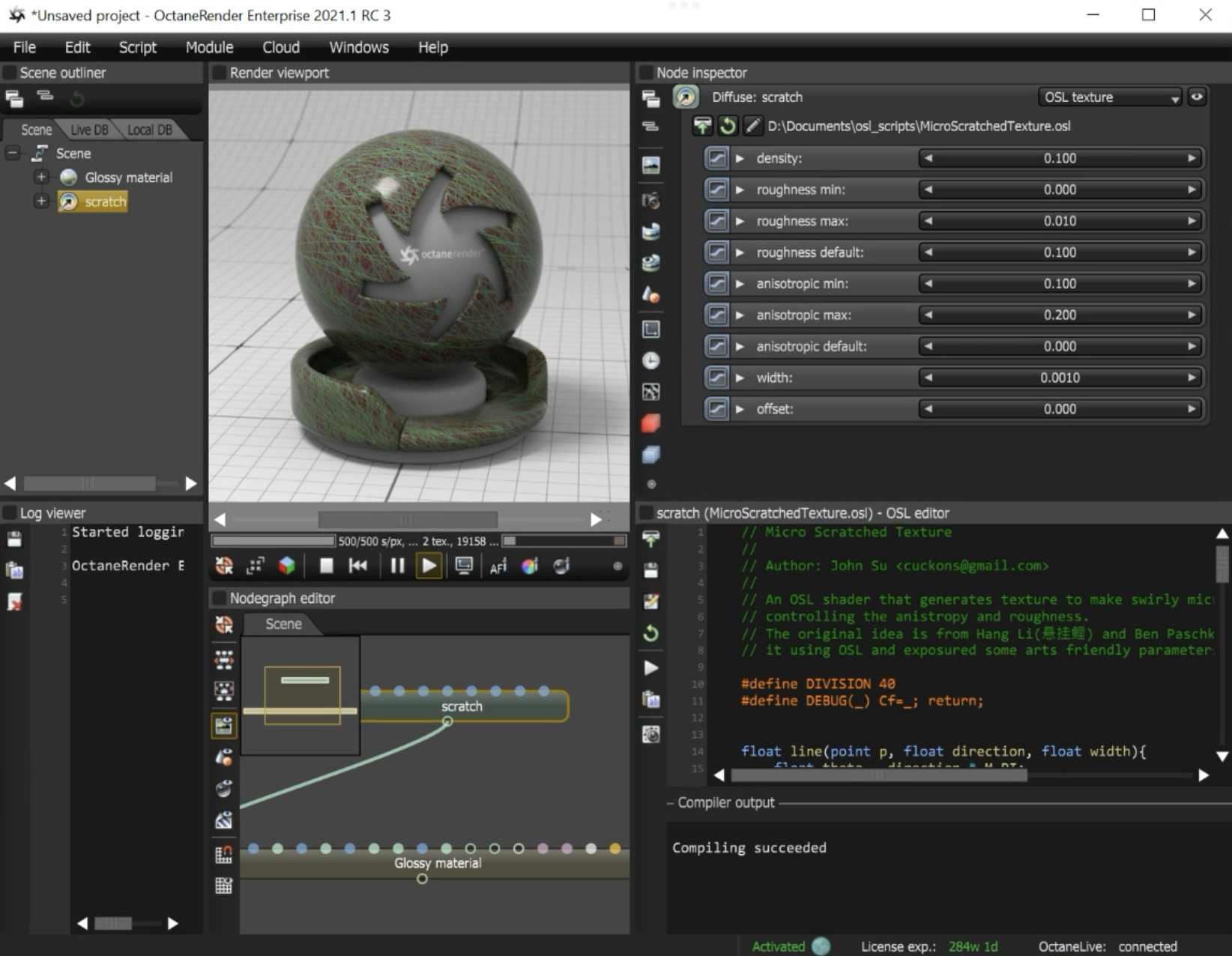

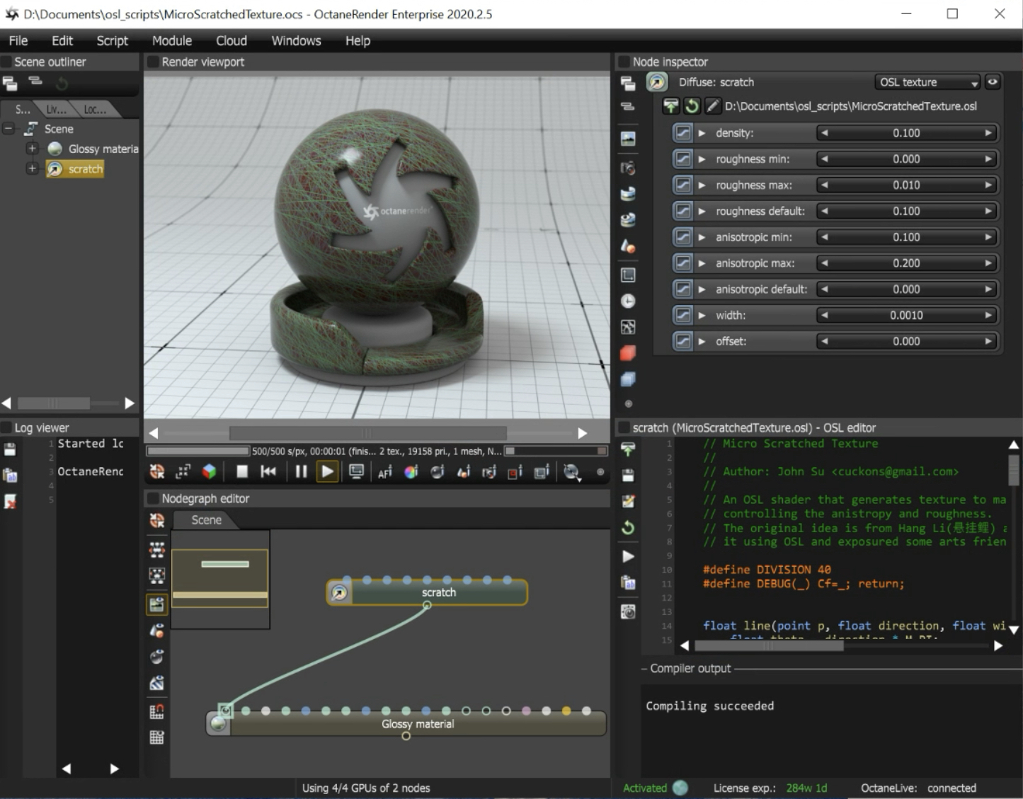

sorry, not a Maya user, but your osl script is working correctly in both Standalone 2020.2.5, and 2021.1-RC3 here:

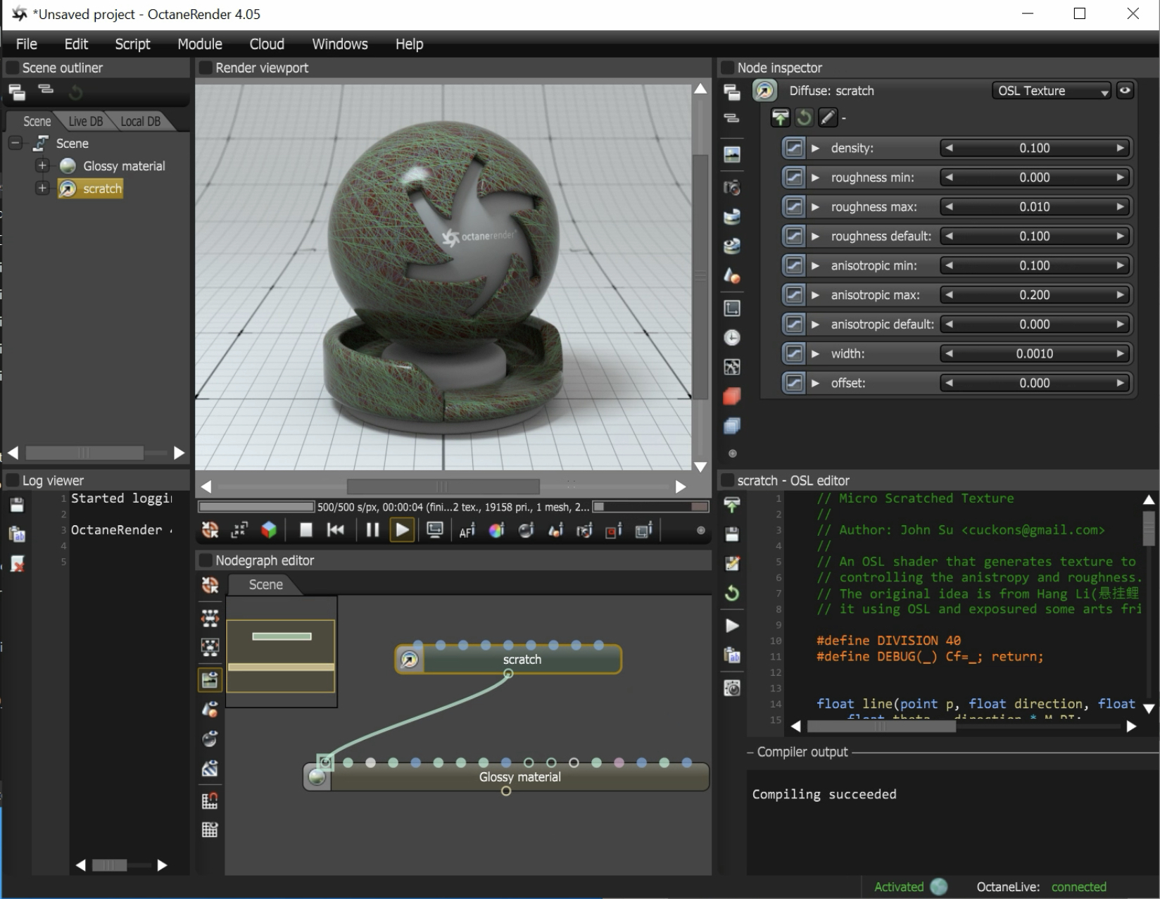

And also in Standalone 4.05:
Please post the issue in the related Maya discussion here:
