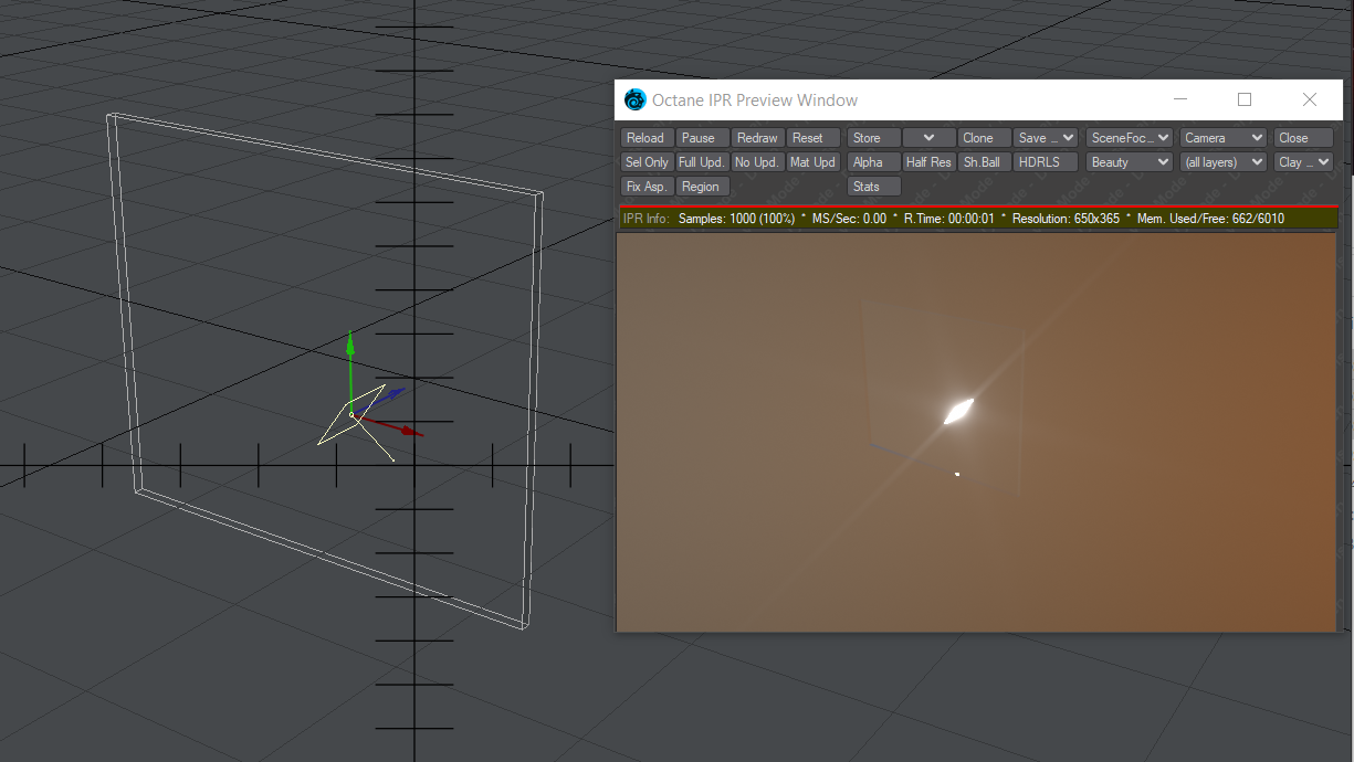

FYI, I've just checked it out and the light is rendered behind a specular object without any problems. Perhaps you have some flags disabled in the light object, or the refraction is too high, so the light object is out of the bent rays.
Thanks,
-Juanjo

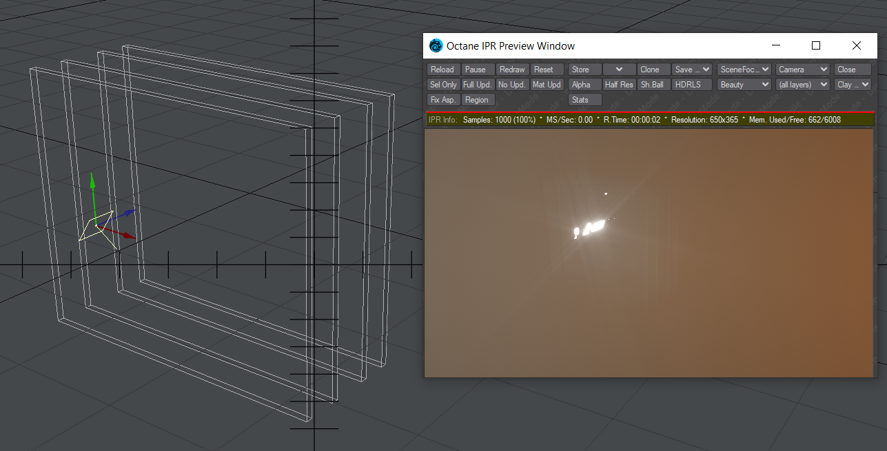

The lights can be rendered even behind multiple specular objects if you have enough specular depth rays in the kernel.
Thanks,
-Juanjo
