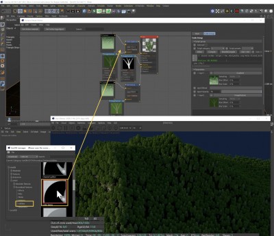

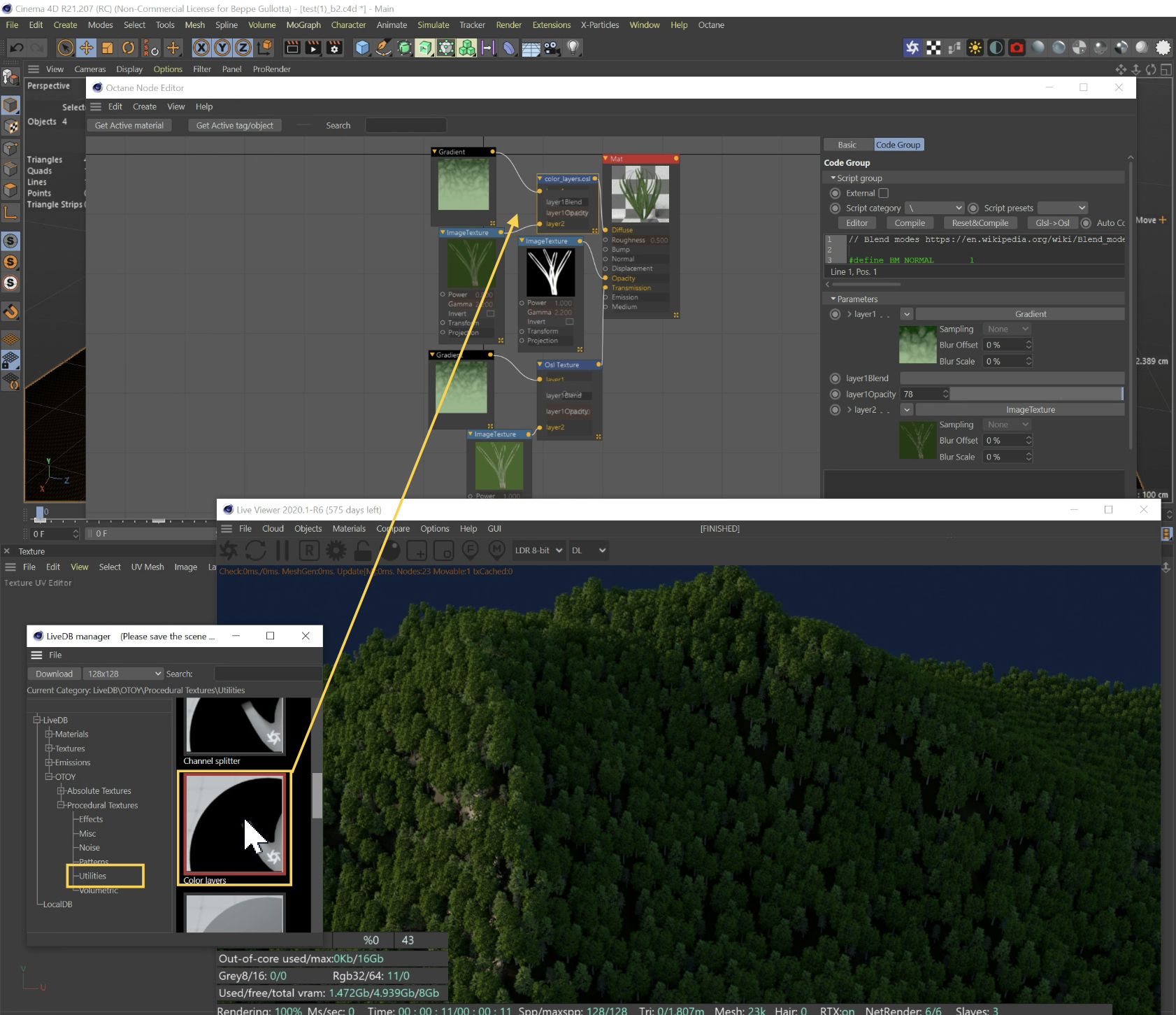

Composite texture is part of the new features added in 2020.2 SDK, but OctaneX is still based on 2020.1.5 SDK.
We need to wait for the next upcoming 2022.1 SDK, to have an OctaneX version based on the same SDK as CUDA.
In the meantime, the Composite Texture can be replaced with the OSL color_layers.osl node that you can find in LiveDB/OTOY/Procedural Textures/Utilities category:
