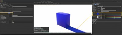

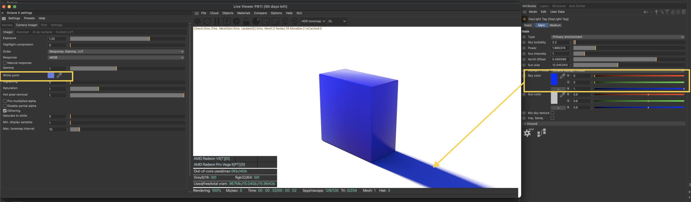

a possible solution is to use the DayLight node, and change the Sky Color to define the color of the shadows, and set the Sunset Color to light gray.
Probably you need to use the White Point picker to correct the white tint:
ciao Beppe
