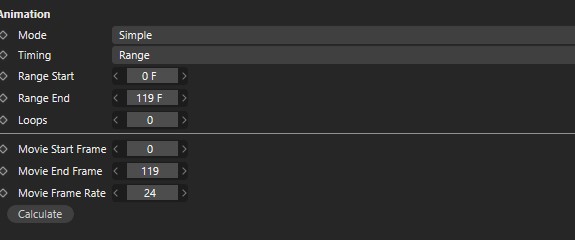

Not sure this will help...but have you tried using an .mp4 movie of that sequence matching your FPS?
I know, I know they tell you not to use them because they won't work, but they are the only thing that have ever worked for me in C4D and Octane consistently. I use .mp4s all the time for animated textures in Octane. And yes make sure it is set to "check materials every frame" on the Main Octane render tab.
Just use a regular C4D material, add the .mp4 as texture in the COLOR tab and go into the animation tab and make sure it recognizes the length—you can click "Calculate" to check. You can leave it as default or change it to a range to start or stop the play back at a certain point. Here's my setting on one.
Anyhow, just a suggestion. Something to try anyway.
