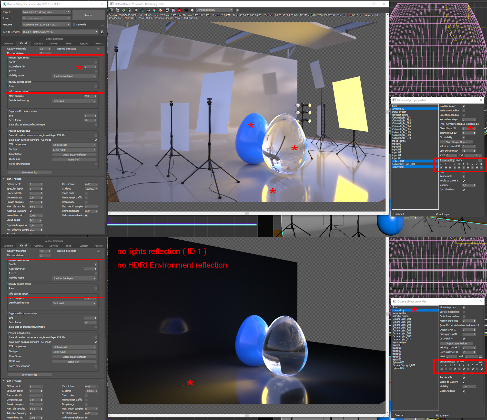

Shadow catcher will get any shadow as it should be.
In order to get reflections you will use the render passes even using Render layer ID.

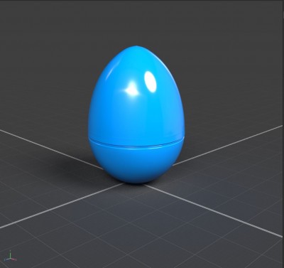

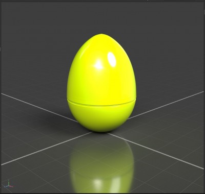

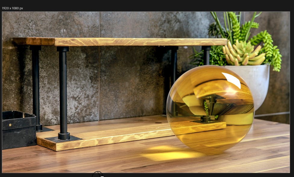

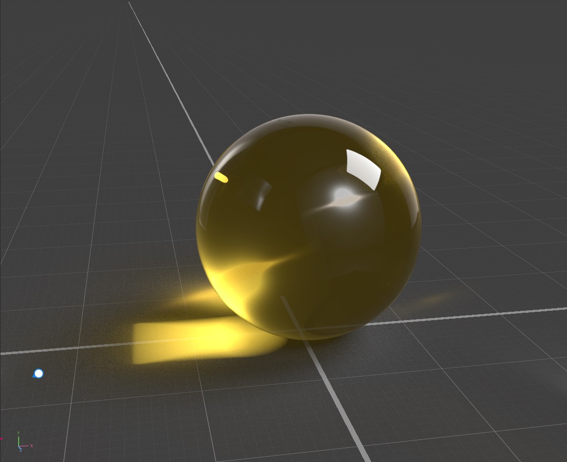

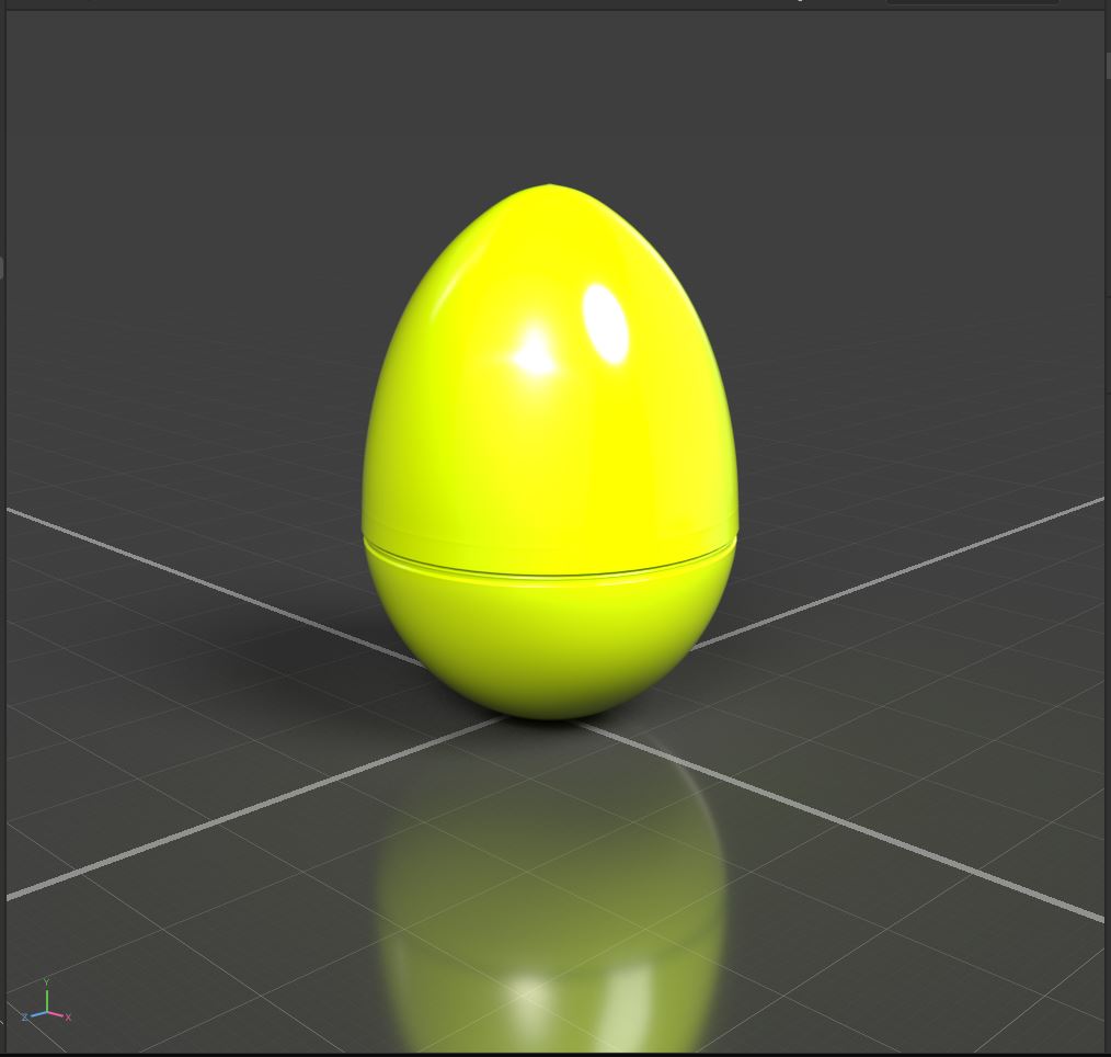

Thank you, maybe you can help me acheive this effect that Adobe Stager produces with the ground plane.
There are shadows, bounced light from the 3d object onto the plane, and reflections.
Thanks for your time.

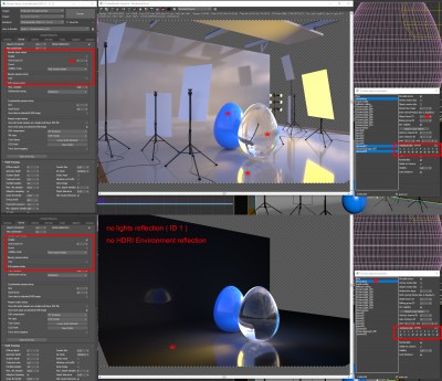

paride4331
Posts: 4001
Hi Carl S.
I'm not sure I understand your question.
I hope it helps.
Regards
Paride
test_octane2021b.zip
(15.59 MiB) Downloaded 297 times

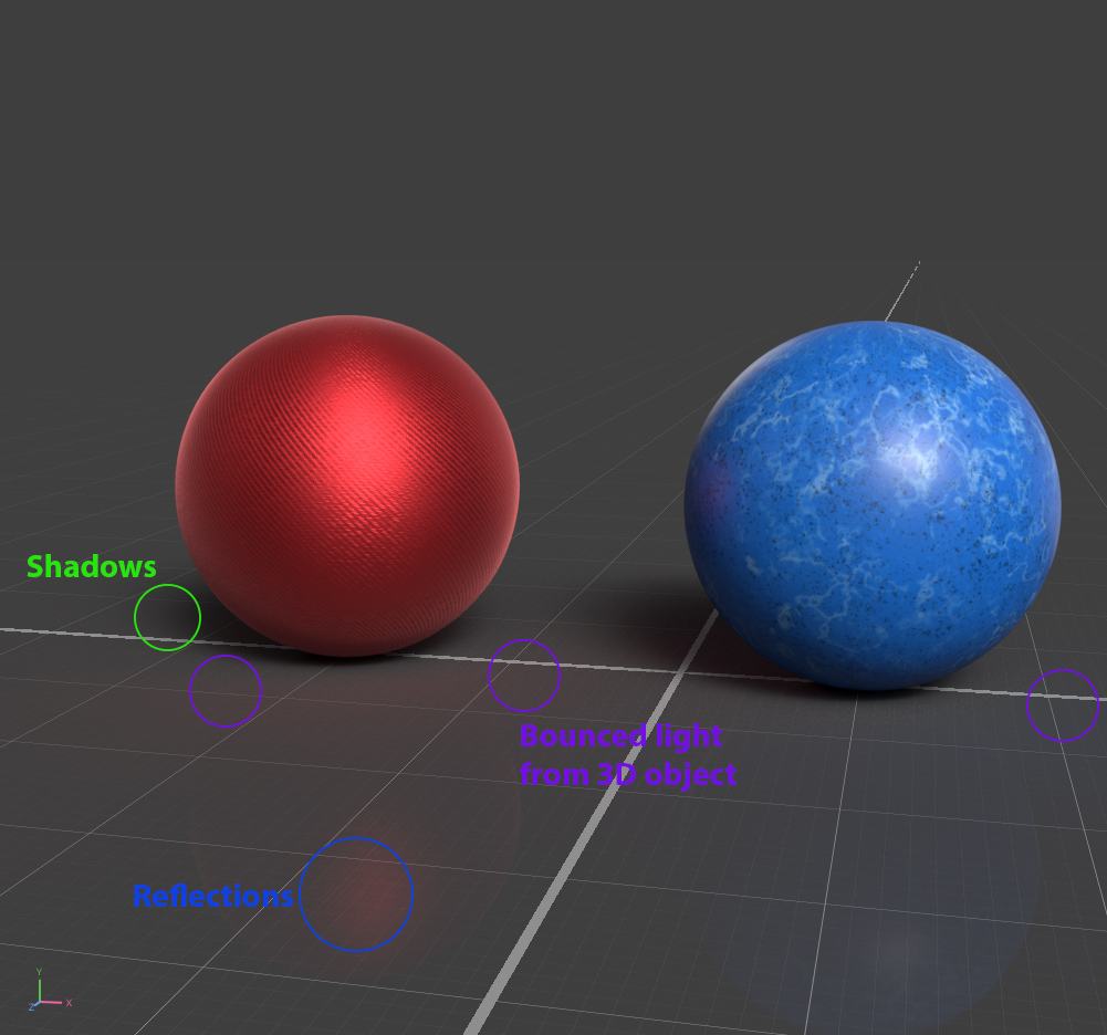

Thank you, sorry for not explaining myself clearly. I am looking to capture the reflections from the 3d object, bounced light from the 3d object, and shadows from the 3D object only, similar to how the matte shadow only captures the shadows from the 3D object. Using the method you described above I still get reflections from the HDRI environment without the bounced light/color bleed off the 3D object onto the plane.

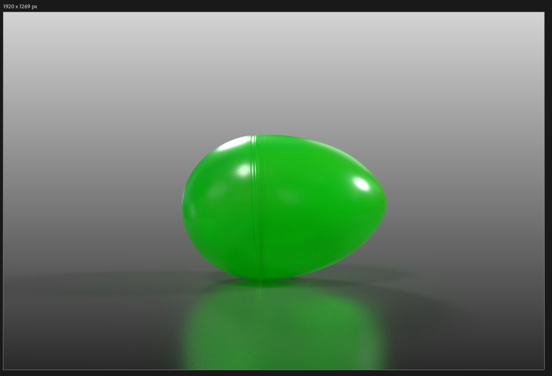

The matte/shadow/reflection material in Adobe Stager can catch the 3D object shadows, 3D object light bounce/color bleed, and 3D objects reflections without capturing the HDRI enviroment reflections all in one pass, one render.
It can also capture caustics.
Similar threads going back awhile, it seems we need an updated matte material desperately.
viewtopic.php?f=27&t=45426&p=226670&hil ... ns#p226670
viewtopic.php?f=27&t=41578&p=198819&hil ... ns#p198819
paride4331
Posts: 4001

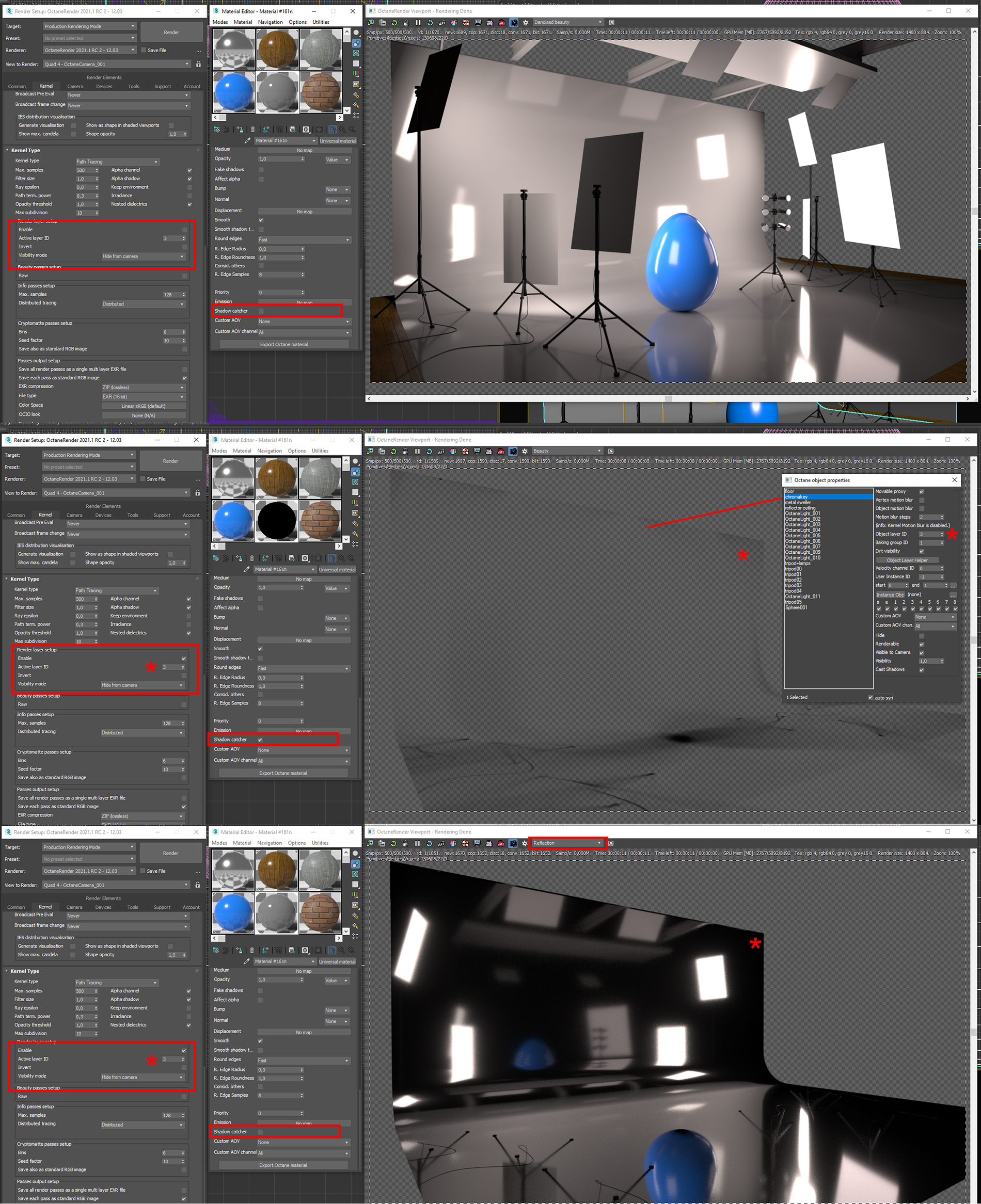

Hi Carl S.
you can use the light passes.
It should help you.
Regards
Paride
test.zip
(21.45 MiB) Downloaded 260 times

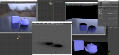

paride4331
Posts: 4001

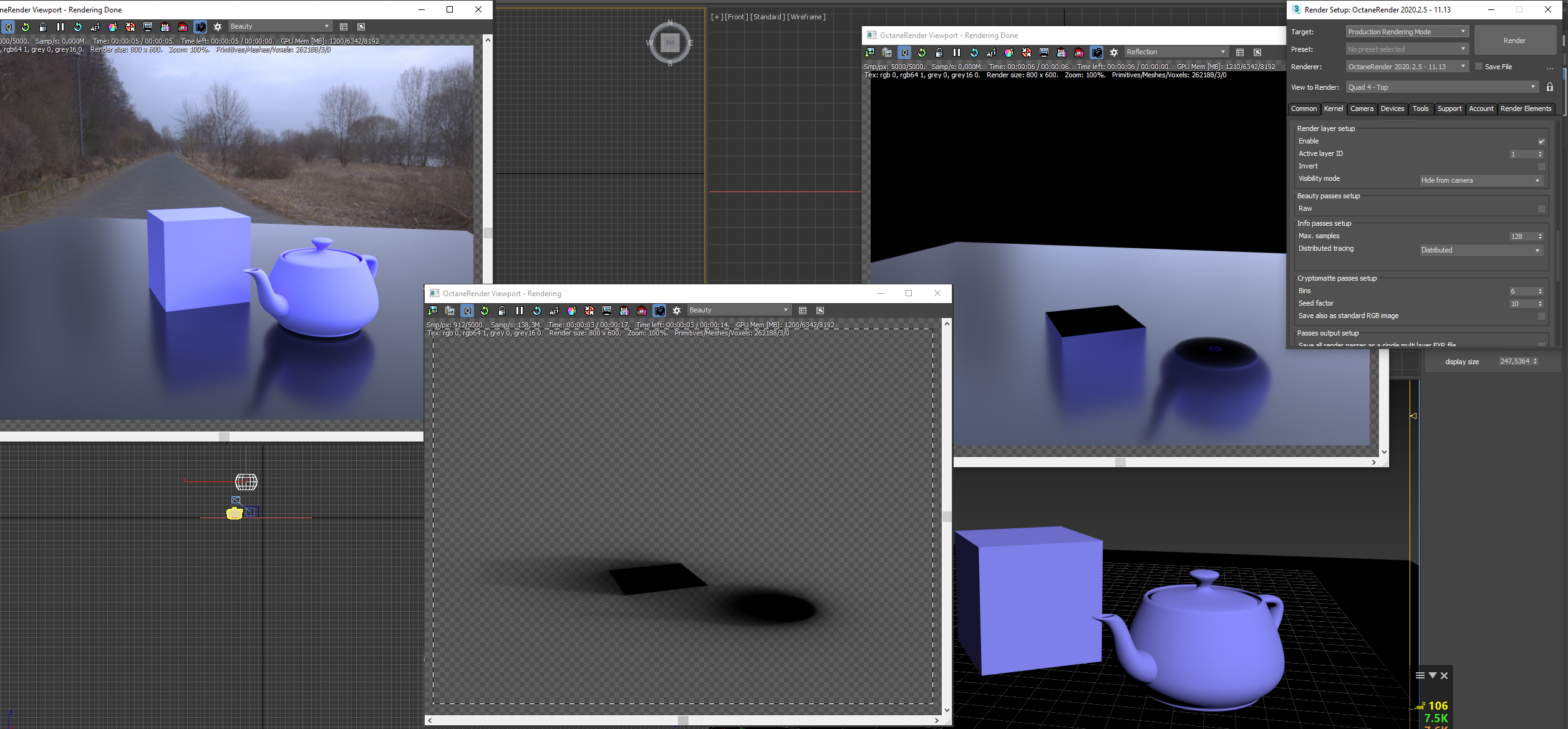

Hi Carl S.
Usually composite workflow should be used.
In any case here are a couple of links could help you.
It has been slightly updated in Octane v2020 but This concept remains similar.
download/file.php?id=59960&mode=view
viewtopic.php?f=51&t=71631
Regards
Paride
