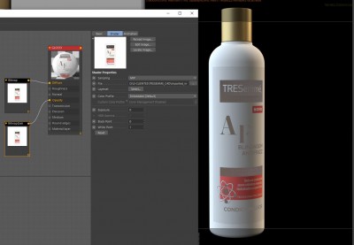

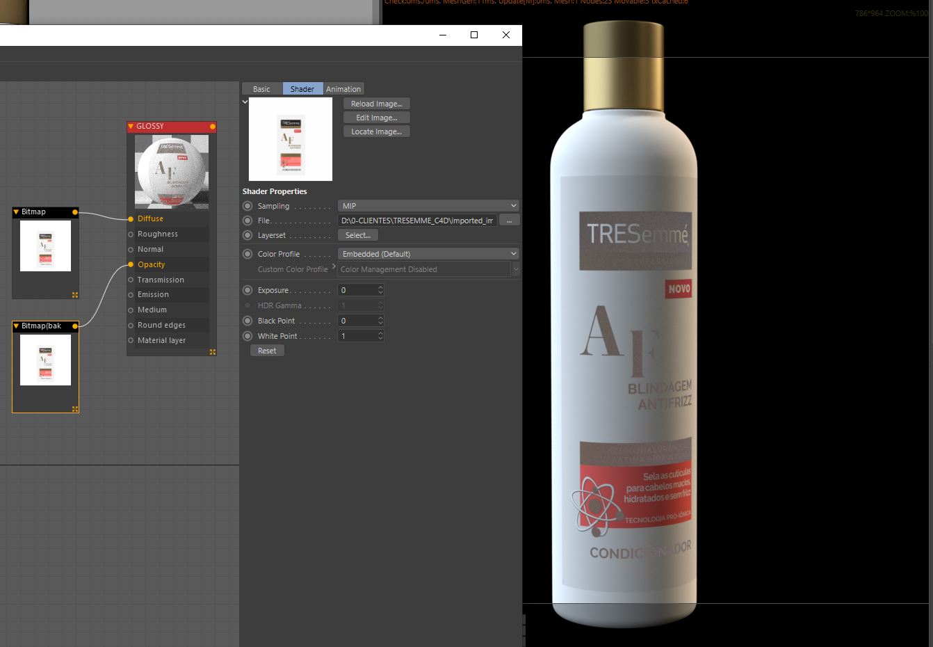

I'm trying to create a label for a product and trying to use a .png alpha to clip the label but octane is not showing this option in the opacity material. Any ideas on how to fix it?
Please have a look at the attached image. Thanks.
Posts: 16068
Location: Türkiye
Never use C4D's Bitmap type. We have own texture types. IMAGETEXTURE is your friend, always use it.
Read manual for "mode=alpha". https://docs.otoy.com/cinema4d//ImageTexture.html
