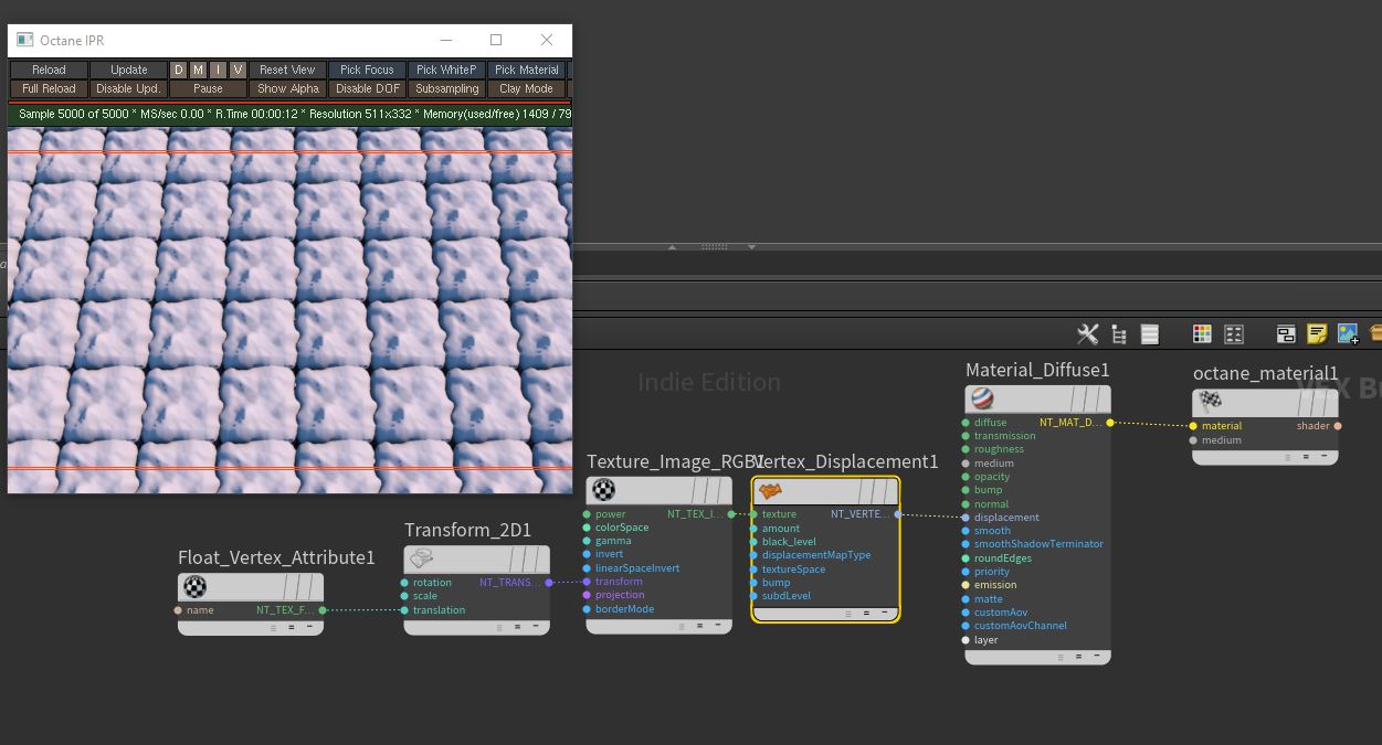

I have a set of rocks which get copied to scattered points. I created random RGB Values and took them to the shader network. Now I want to use this data to translate the "transform2D node" procedurally, so that every copy of rock has a different offset in there texture maps.
I already tried using the channel split, both with 2021 and also with OSL shaders, but with no luck. I did notice that the "Texture OSL" only outputs texture color data and no plain float values (like the "Value Float" Node does)
Also, I still dont understand why the extracted R component of an RGB Vector is not seen as a single float value which is understood by other nodes and is able to drive them.. Or why the values cannot easily be converted like in VOP "vec to float", "float to vec", "float to int" and so on..
It is like I miss an Input on the "Value Float" Node which converts the texture to float, Same goes with "Value Int" as some node parameters only accept INT or float and its a pitty I cannot create and control them in SOP and import via Point Attributes.
I hope the screenshots clarifies what I mean.

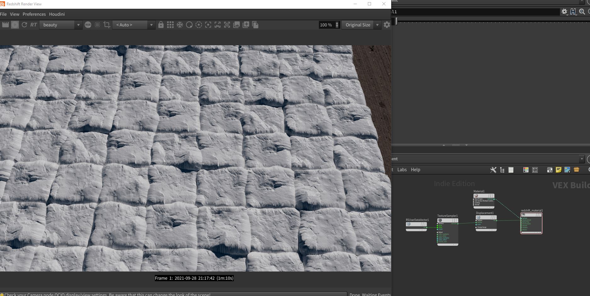

Hi Juanjo,
thanks for getting back to me.

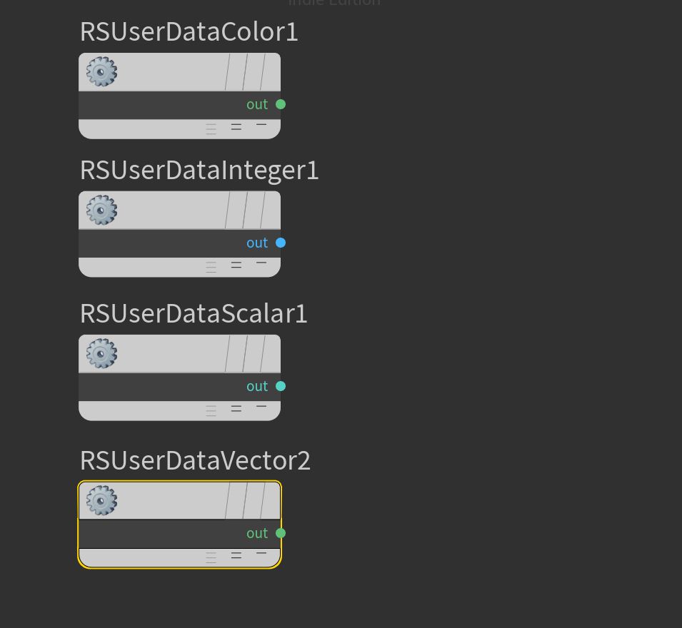

I just checked and rebuild the setup with redshift which is able to do what I want and offset the texture by point attribute data.
I think the problem is that octane imports or reads all point attribute data as color data only. (as far as I understand it)
in redshift it can be specified what we would like the data to be interpreted. Thats why we can use it in any way we like. Arnold also does this. (see screenshot)
This is what I would like to have in octane aswell..
Can you, if your time allows for it, elaborate, if this is a big deal to implement in octane, or is it fairly simple to do?

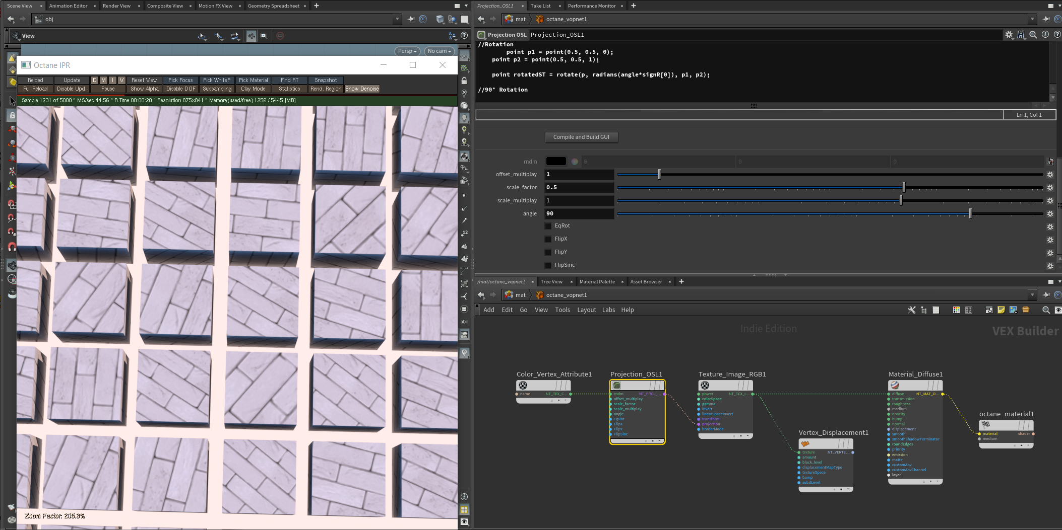

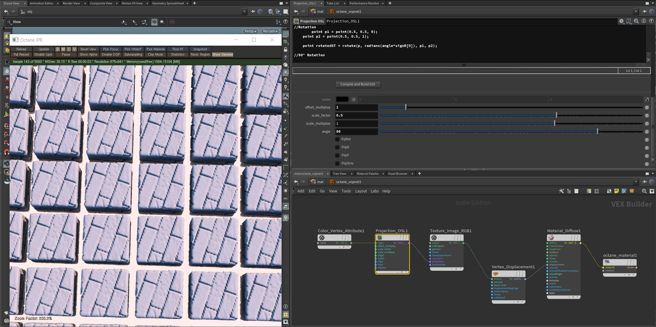

Anyway, even without instancing, I think that this workflow doesn't work with Octane because the displacement nodes don't support the modification of the mesh UV. It works with color or bump maps, but not with displacement. Attached you have an example scene including an OSL node to randomize the UVs, but it doesn't work for displacement
