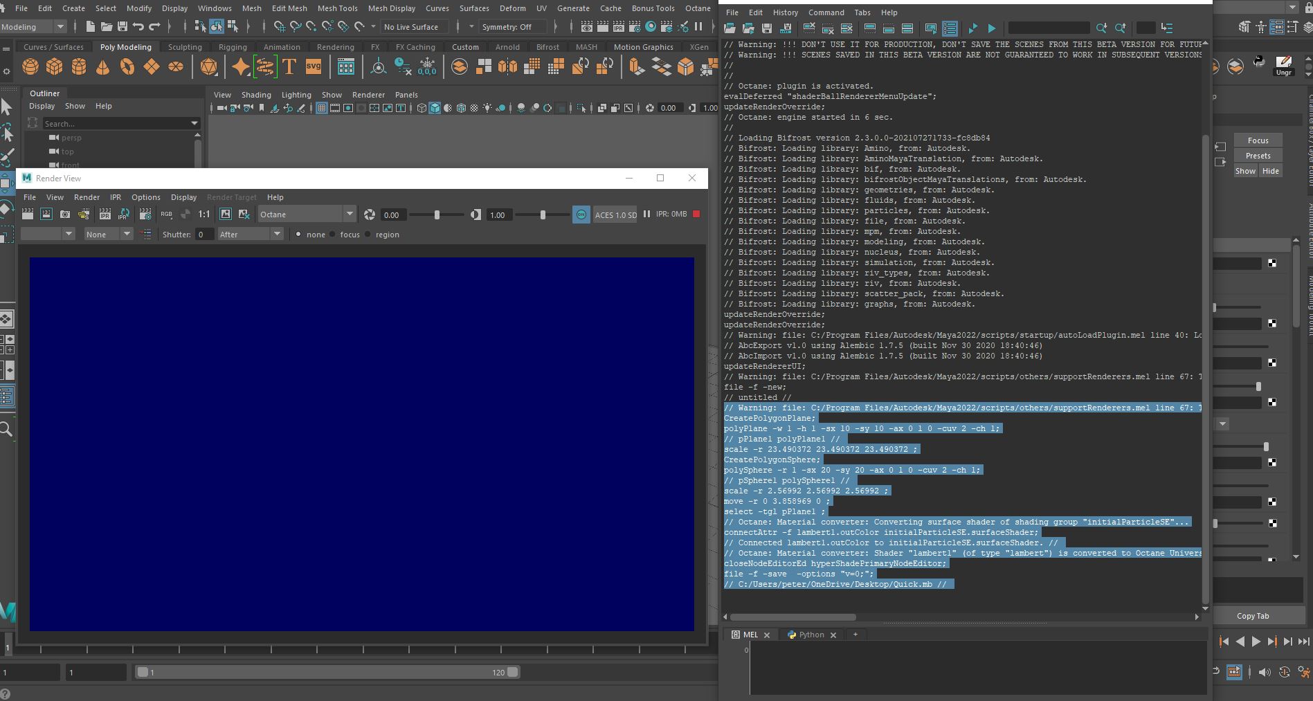

I am able to export an orbx and this runs fine in the standalone
But no rendering view in octane viewer window
No errors in script or no freezes... just blue screen
Using Maya 2022.1
Cut ID: 202106180615-26a94e7f8c
OctaneRender Standalone 2021.1 RC2
OctaneRender for Maya 2021rc2-20.5 [BETA]
Anyone else have this issue?

I should calrify "blue screen" this is in the ipr render window... not a blue screen windows crash.
So the scene file "plane, sphere, daylight env.
The hypershade renders a thumbnail so I believe the octane render engine is engaged and appropriately matched.
Plus the script editor says
// Octane: plugin is activated.
evalDeferred "shaderBallRendererMenuUpdate";
updateRenderOverride;
// Octane: engine started in 6 sec.
// Warning: file: C:/Program Files/Autodesk/Maya2022/scripts/others/supportRenderers.mel line 67: The renderer "arnold" used by this scene, is not currently available. The "mayaSoftware" renderer will be used instead. To prevent this message from being displayed in the future, set the environment variable: MAYA_NO_WARNING_FOR_MISSING_DEFAULT_RENDERER=1 //
CreatePolygonPlane;
polyPlane -w 1 -h 1 -sx 10 -sy 10 -ax 0 1 0 -cuv 2 -ch 1;
// pPlane1 polyPlane1 //
scale -r 23.490372 23.490372 23.490372 ;
CreatePolygonSphere;
polySphere -r 1 -sx 20 -sy 20 -ax 0 1 0 -cuv 2 -ch 1;
// pSphere1 polySphere1 //
scale -r 2.56992 2.56992 2.56992 ;
move -r 0 3.858969 0 ;
select -tgl pPlane1 ;
// Octane: Material converter: Converting surface shader of shading group "initialParticleSE"...
connectAttr -f lambert1.outColor initialParticleSE.surfaceShader;
// Connected lambert1.outColor to initialParticleSE.surfaceShader. //
// Octane: Material converter: Shader "lambert1" (of type "lambert") is converted to Octane Universal material ("lambert1")
closeNodeEditorEd hyperShadePrimaryNodeEditor;
file -f -save -options "v=0;";
// C:/Users/peter/OneDrive/Desktop/Quick.mb //
So still not sure what might be causing it

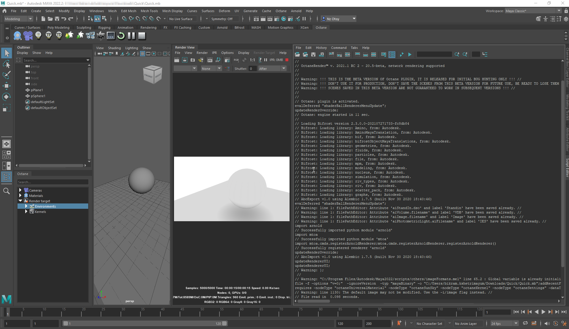

p3taotoy
Posts: 227
Joined: Sat Nov 24, 2018 1:06 am
Location: Washinghton, USA and Waikanae, New Zealand
Thanks for following up.
After a couple of reinstalls I am now rendering in maya with octane.
Thanks for your patience and help
Peter
