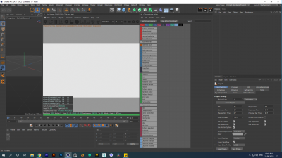

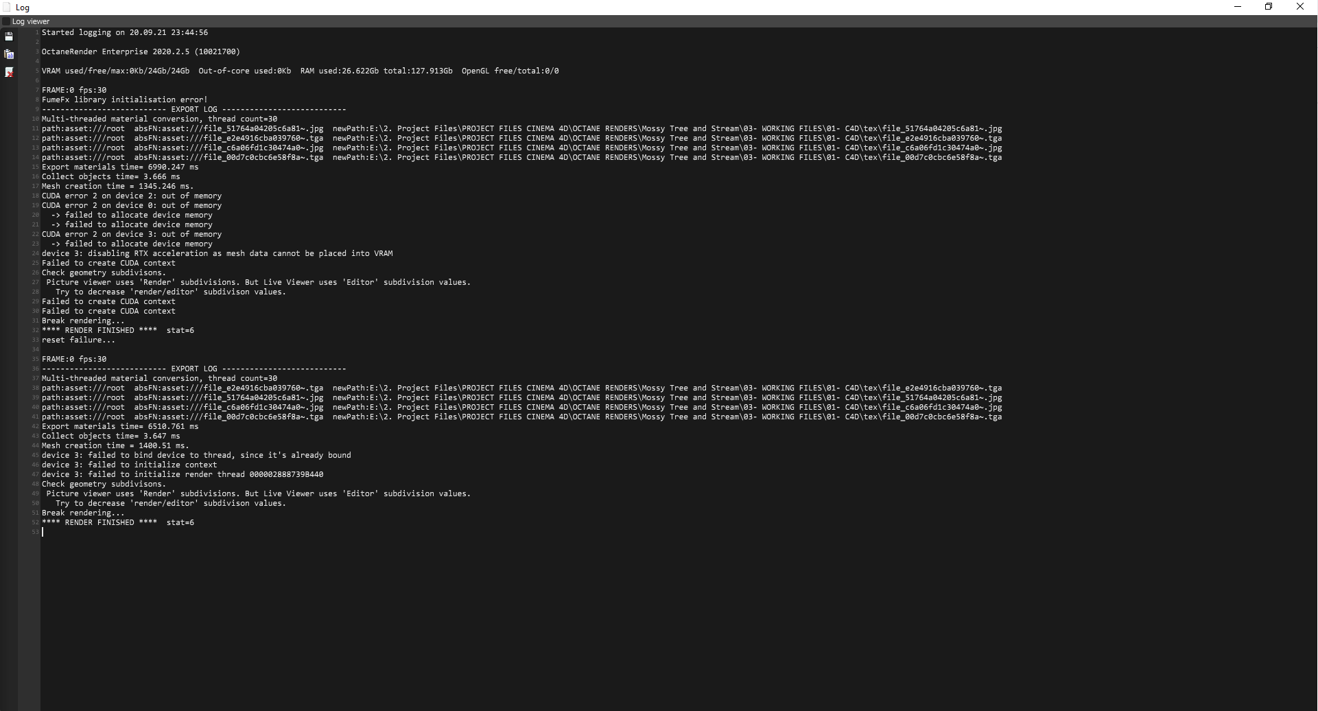

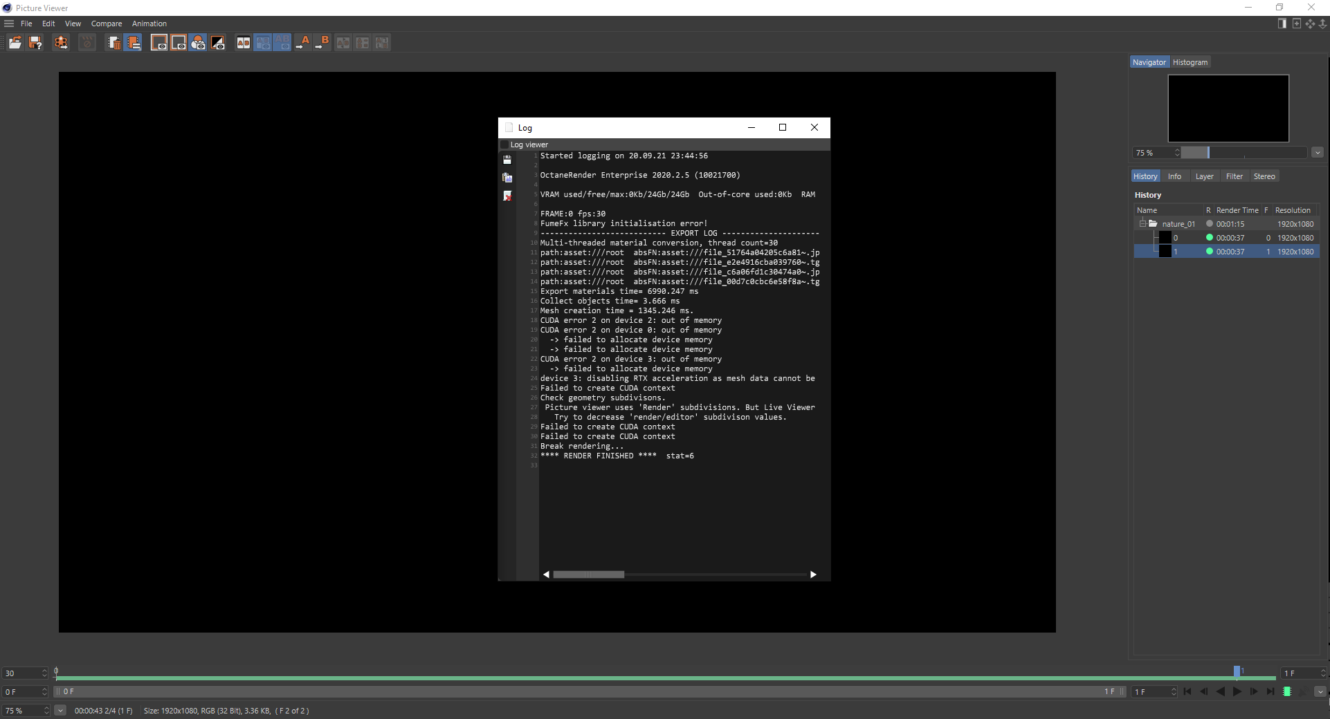

It is showing errors (check attached images).

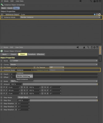

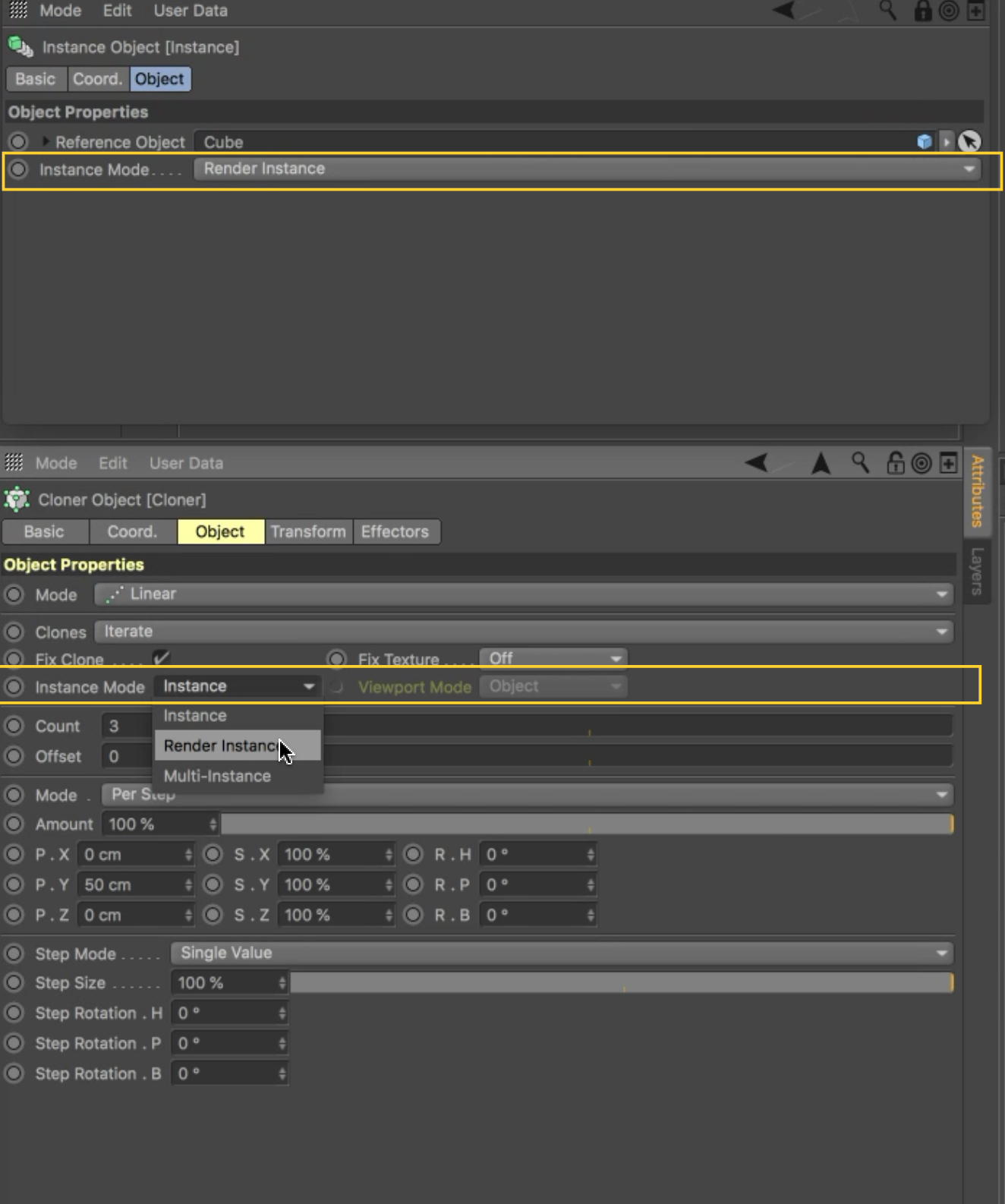

to keep the polygons count low, it is very important to enable in c4d the Render Instance, or Multi Instance option for all the objects that support it, like MoGraph Cloners, Instance Objects, or Particle Emitters, or even 24GB of VRAM could not be enough, especially in nature scenes:

I do have multi-instance checked in mo-graph.

And it did started the render but now new things are happening, I am rendering the scene with 1000 max samples in octane kernel setting. But my render always stops after calculating 992/1000, and clocks keeps on ticking but render stops as all gpu stops.
