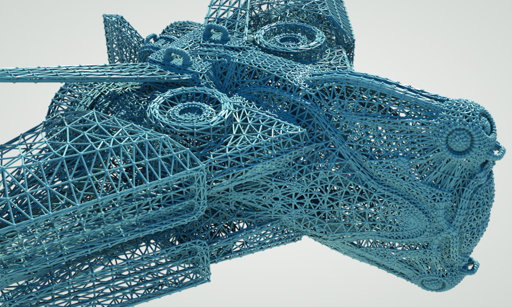

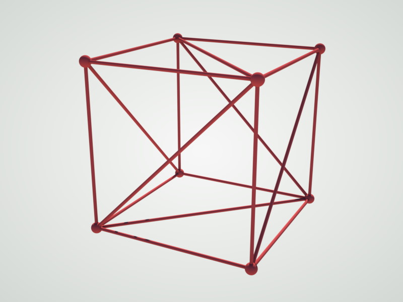

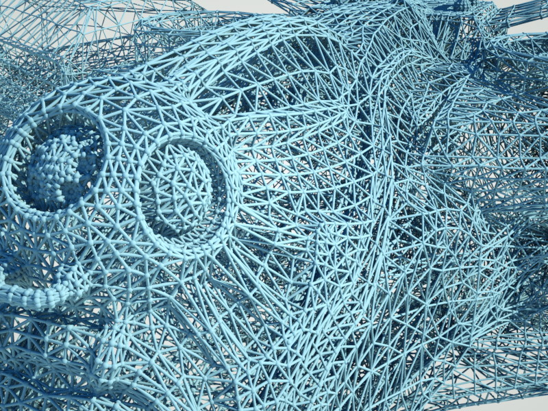

This is a script to create a solid wireframe version of a mesh. The script goes through the polygons and replaces edges with hair primitives and vertices with spheres.
