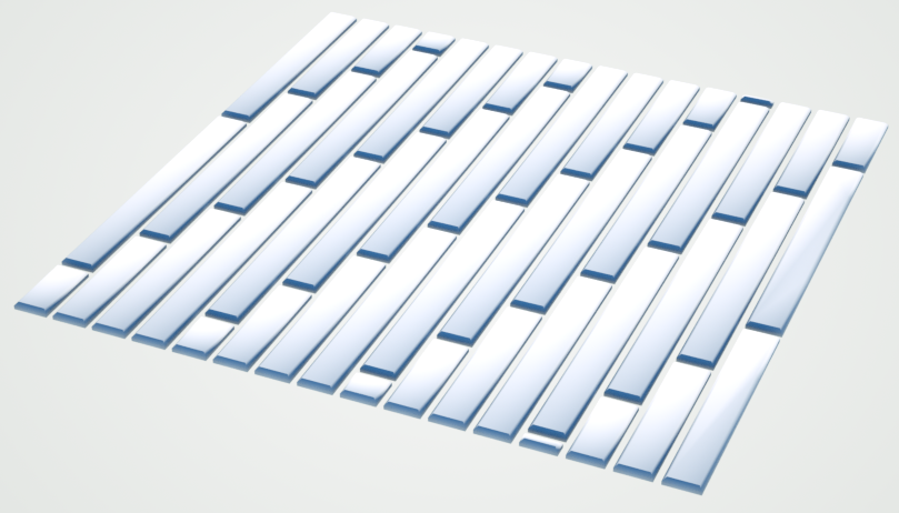

For this example I will use this floor geometry created in 3DSMax with the FloorGenerator plugin. This is a single OBJ file.

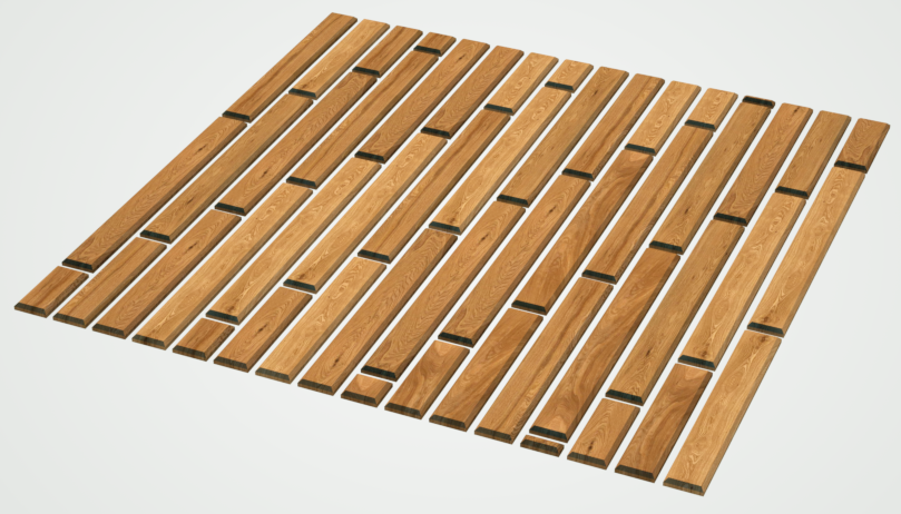

4. Texturing
Any texturing applied to the input geometry will also be applied to the modified copy.

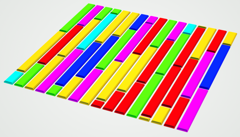

4.3 Add a Gradient map texture node. Plug the Random map into it. Set the interpolation to Constant and add some control points.
You should get something like the following.

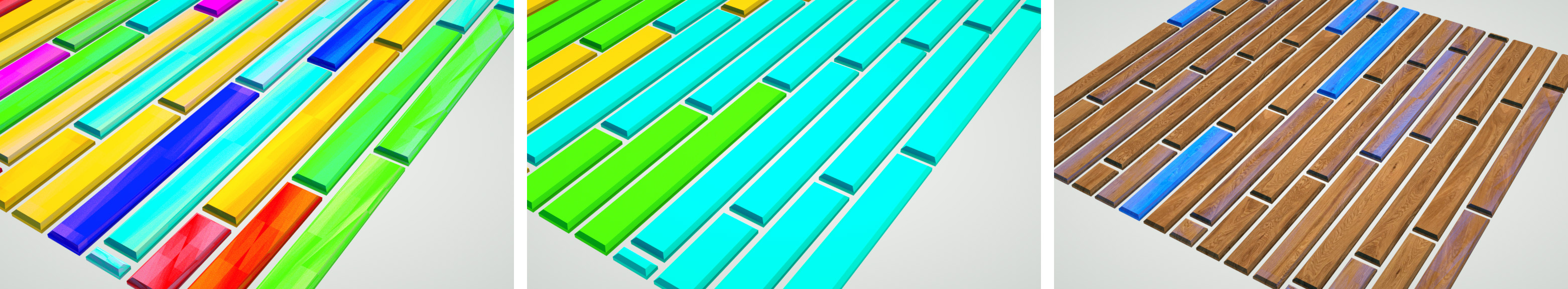

We have assigned colors randomly to the isolated elements of the geometry.
Instead of simple colors, you can use actual textures as the values of the Gradient map's control points, as in the first image.

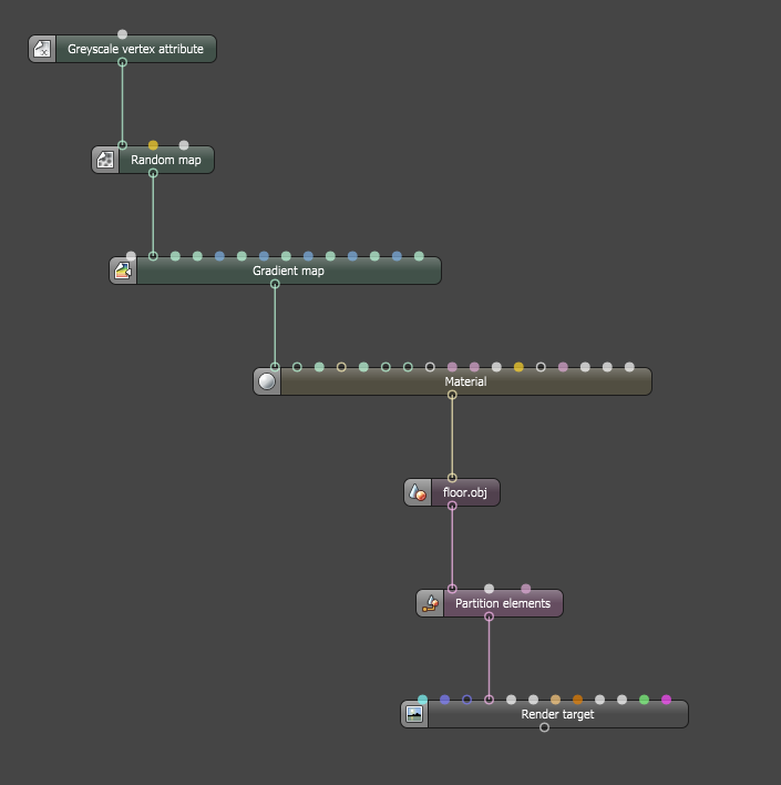

The final graph looks like this:
Tip: The Input scale field in the Random map node can be used as a seed to change the result.
