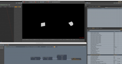

Attached is the modo scene and a screengrab of my setup.

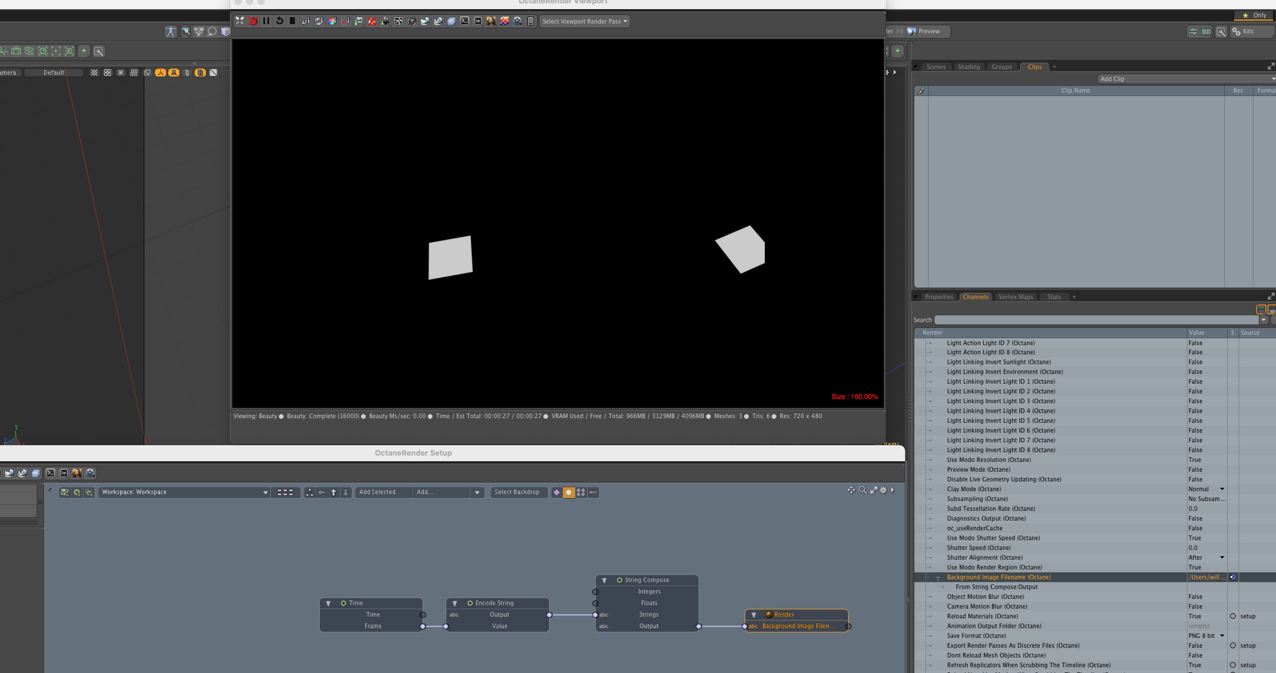

What I have is workspace the gets the current frame and makes a string with the filepath for an image sequence. Then I have that value being fed into the "Background image Filename (Octane)" channel. There are a few questions & comments I have about this
1. If I load one of the images directly in the Octane kernel settings, it loads and I can see it. I have alpha enabled and I can confirm the file is loadable as a background, just not animated.
2. When I create this channel link, Octane doesn't complain. If I intentionally mess up the filename feeding the background image filename, Octane gives the "Error loading background image" alert. So it does seem like Octane is seeing a file to load and attempting to load it; however, the background is black.
3. The Background image Filename (Octane)" channel when I hover in the schematic editor says it's a gradient? I haven't found a gradient that this channel seems to accept. The only way I was actually able to link the string to that channel is by using the channel links editor and making a direct link. Again, it seems like Octane accepts this, but it doesn't want to make it easy.
I've tried clicking around in the kernel animation panel to load textures each frame or any related things but it doesn't seem lik it wants to load my image.
Any ideas on if this can work without some complex plane with a texture mapped to it transforming with the camera?

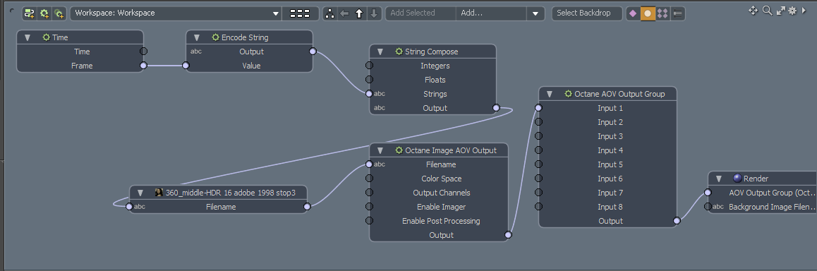

Hi
The Background Image is read from frame 0, so I don't think this approach will work.
Instead, use the latest Octane 2021.1 version, with a node setup similar to:
Paul
