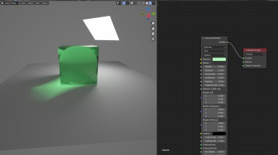

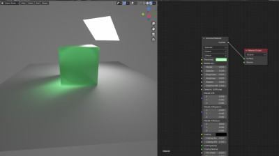

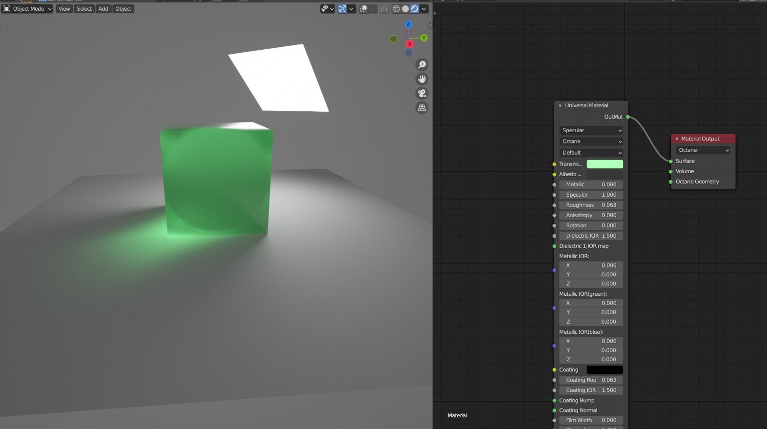

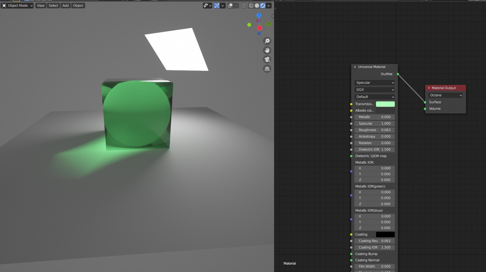

Hi, I don't know if it's a bug or some kind of change in the engine, but Universal Material with Specular type looks different in 2020.2 and up compared to 2020.1.5
2020.1.5 Universal, Specular
2020.2.X Universal, Specular
2020.1.5 Universal, Specular-GGX
2020.2.X Universal, Specular-GGX

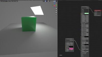

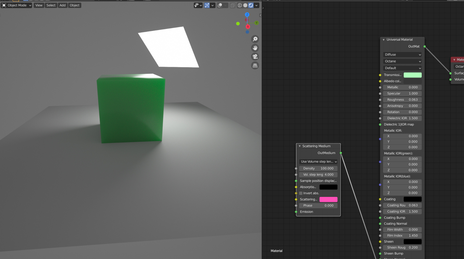

However, Universal Material with type Diffuse and Specular Material look identical. The strange behavior applies only to Universal Material with Specular type. RTX ON/OFF does not affect the result. Nested Dielectrics are OFF.
2020.1.5 Universal, Diffuse + medium
2020.2.X Universal, Diffuse + medium
wallace
Posts: 194
Joined: Sun Dec 18, 2016 10:38 pm
This was indeed a fix for the universal material when you mix the diffuse reflection lobe with the specular transmission lobe. The problem before was that the diffuse reflection was lobe was causing some darkening when the ray exits the material from inside (2020.1).
