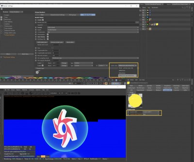

Dear Octane team. I need to obtain a render pass of content of glass bottle. How can I do that if possible? Thanks you for your reply.
Posts: 10563

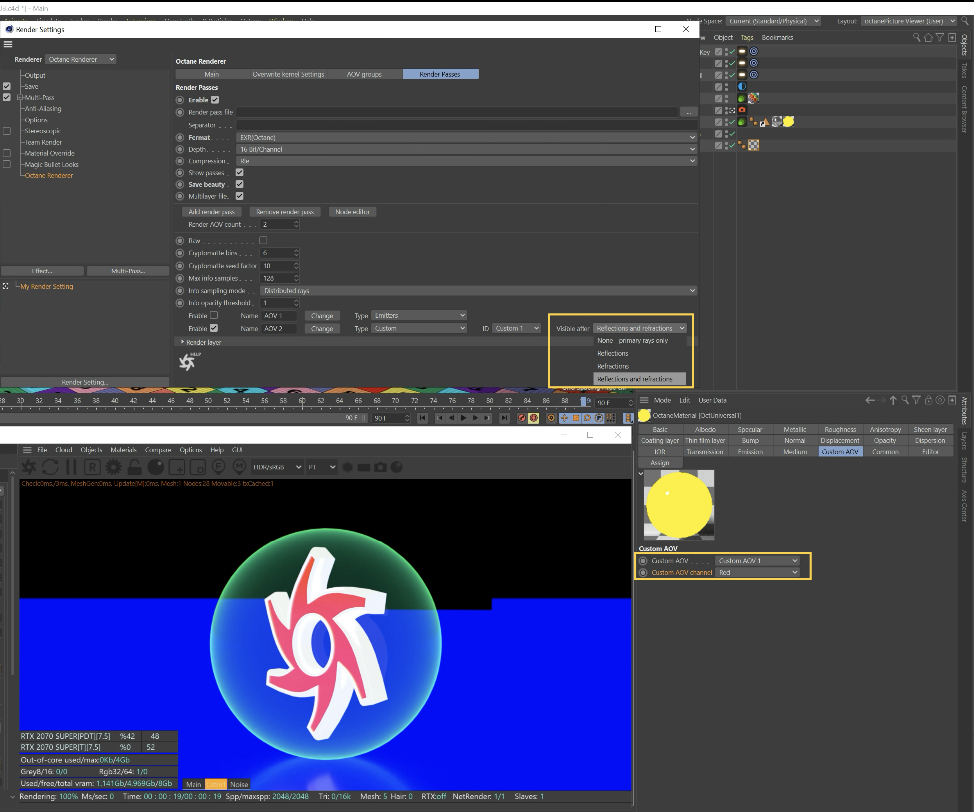

from 2021.1 you can add a Custom AOV to your materials, and control if visible in reflections/refractions, or not:
ciao Beppe
