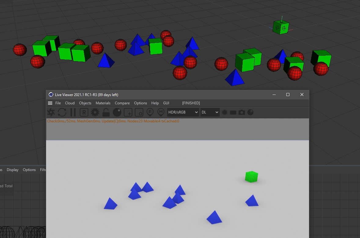

Octane shows only one object from Scatter reference objects list :

aoktar wrote:Check this version
viewtopic.php?f=85&t=78286&p=403690#p403690
Thank you, works perfectly now Image
