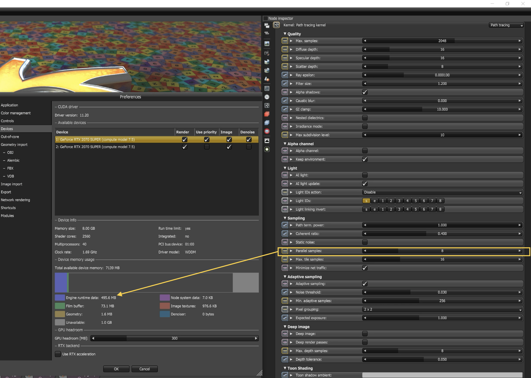

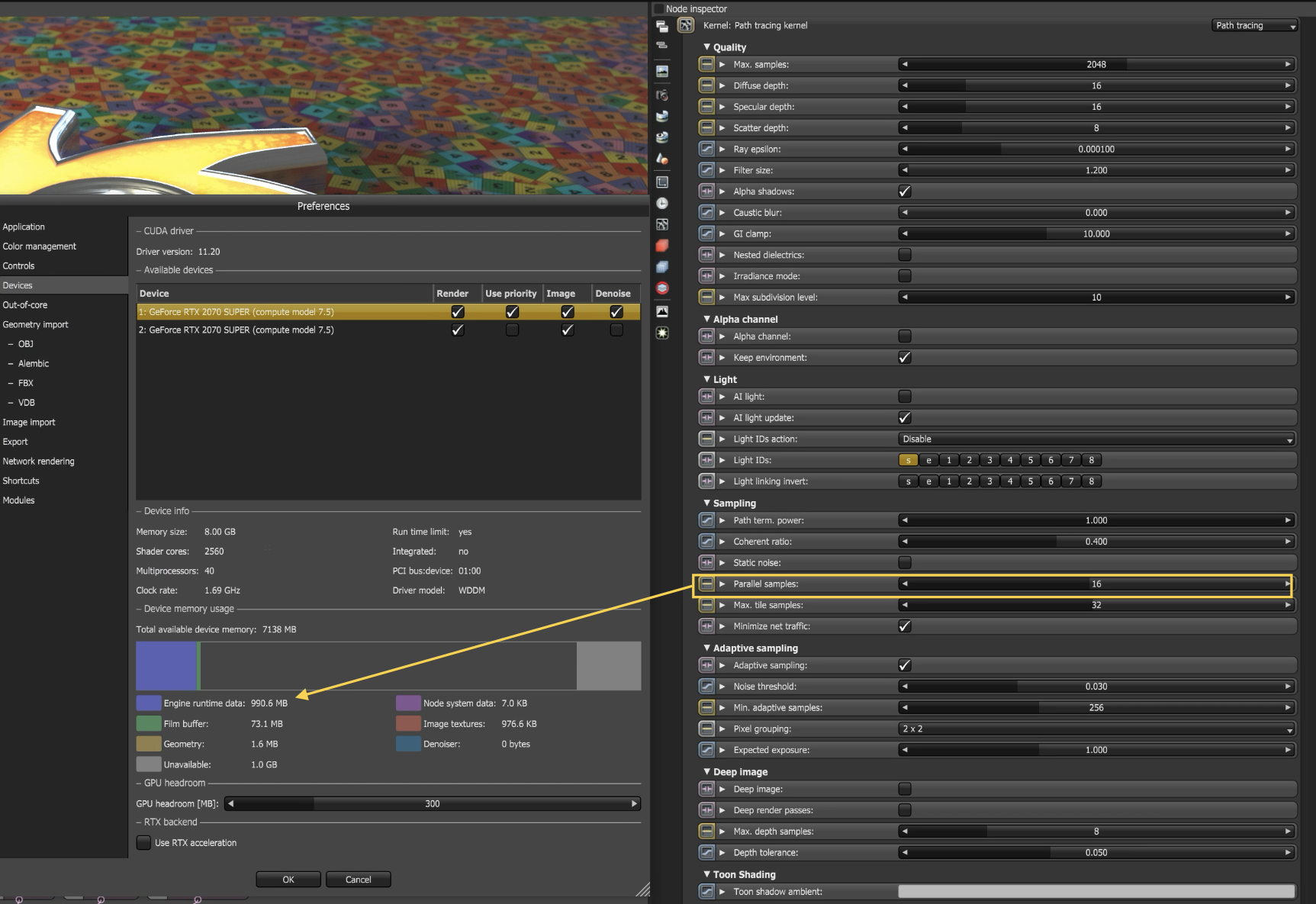

sorry, not a Blender user, but you can reduce the amount of VRAM used for the Engine runtime data, by reducing the Parallel Samples value in the Kernel settings:
Parallel Samples = 16 = 990MB
Parallel Samples = 8 = 495MB
But please note that reducing the Parallel Samples has an impact in speed, ~25% less from 16 to 8.
ciao Beppe
