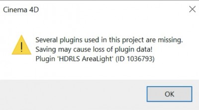

I have a missing plugin error:
Anyway please try with the following version:

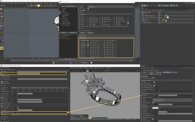

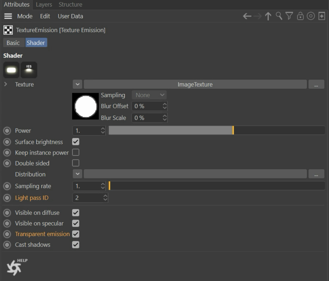

I have cjanged the Light ID of one light, and enabled the Transparent Emission option for both lights:

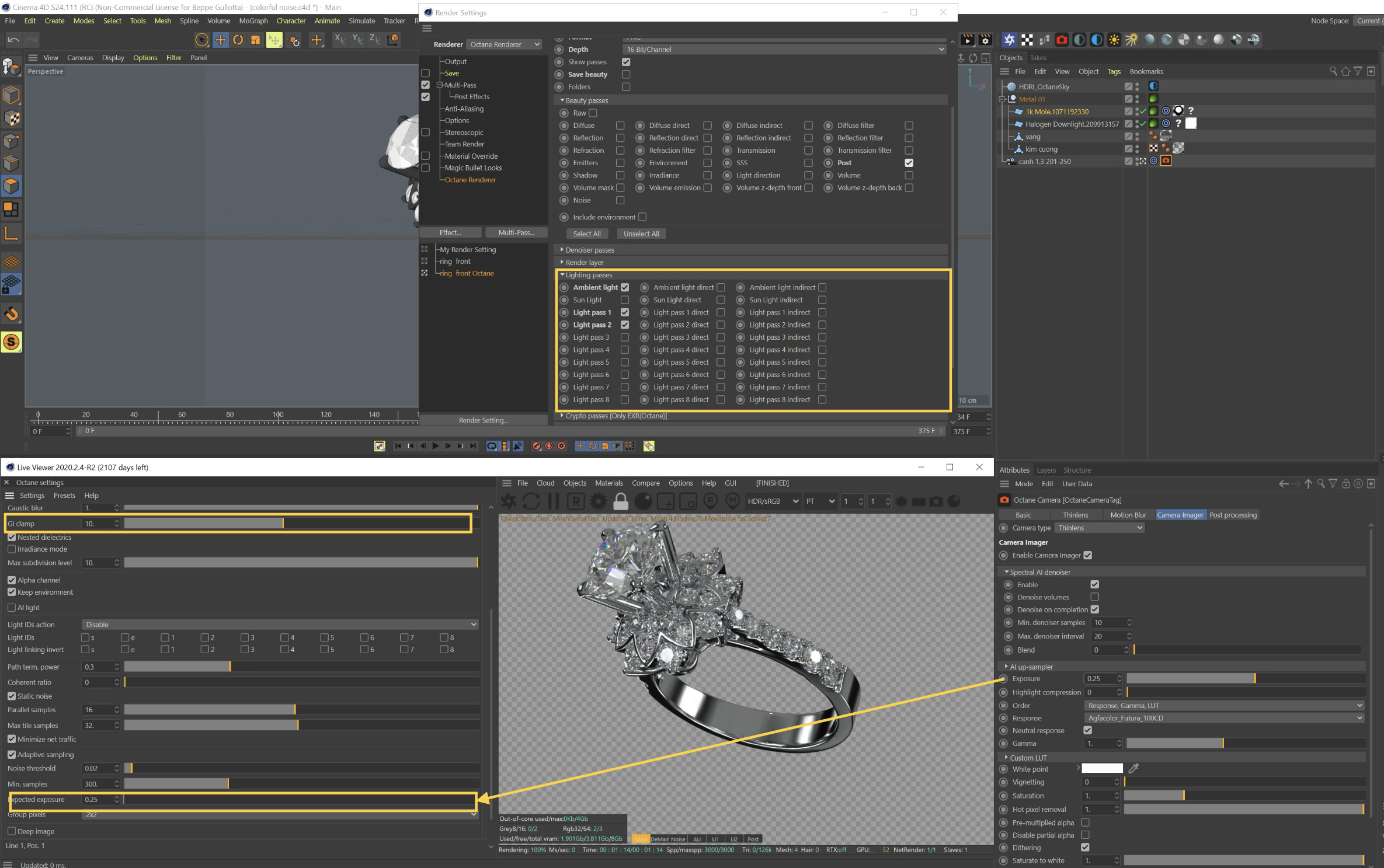

Then reduced the GI Clamp to 10, copy pasted the Exposure from the Camera Imager to the kernel panel in the Expected Exposure field, and enabled the multi light passes, so you can evaluate each light and environment separately.
I don't see colored noise, but only dispersion, anyway, I have enabled the AI Denoiser for the final touch.
