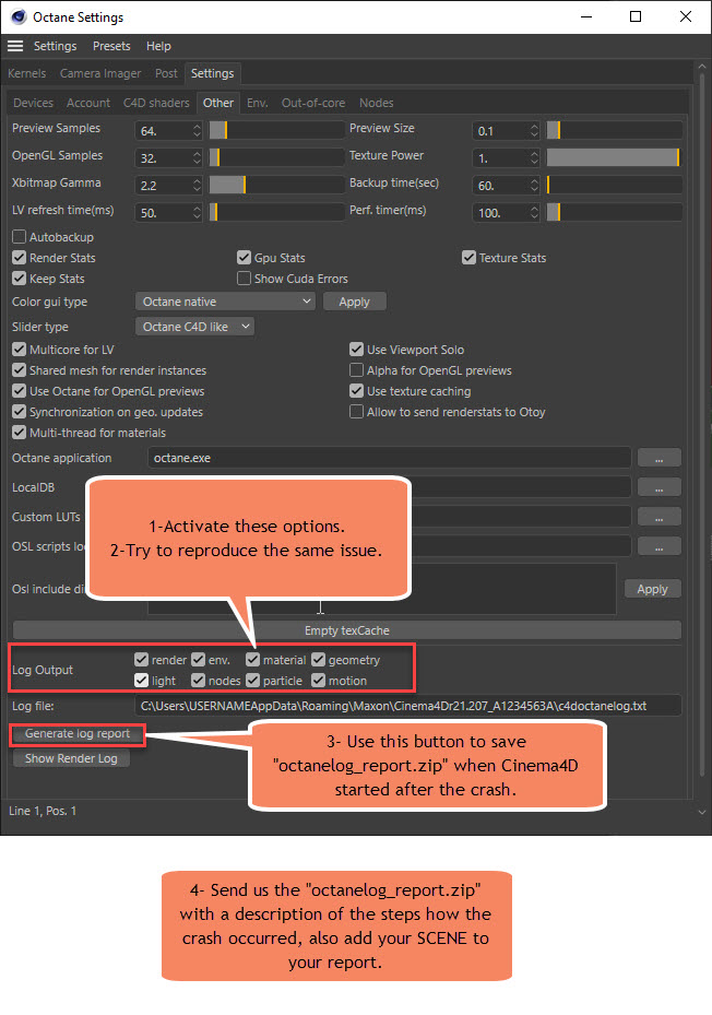

2020.2.4 is very stable. If you have random crashes it means there's some issues on your system. Post some useful data to us for lighting your way. Start with sending some bugreport information as described in the picture.

Ok will do. Thank you for your patience and sorry for the rant.
