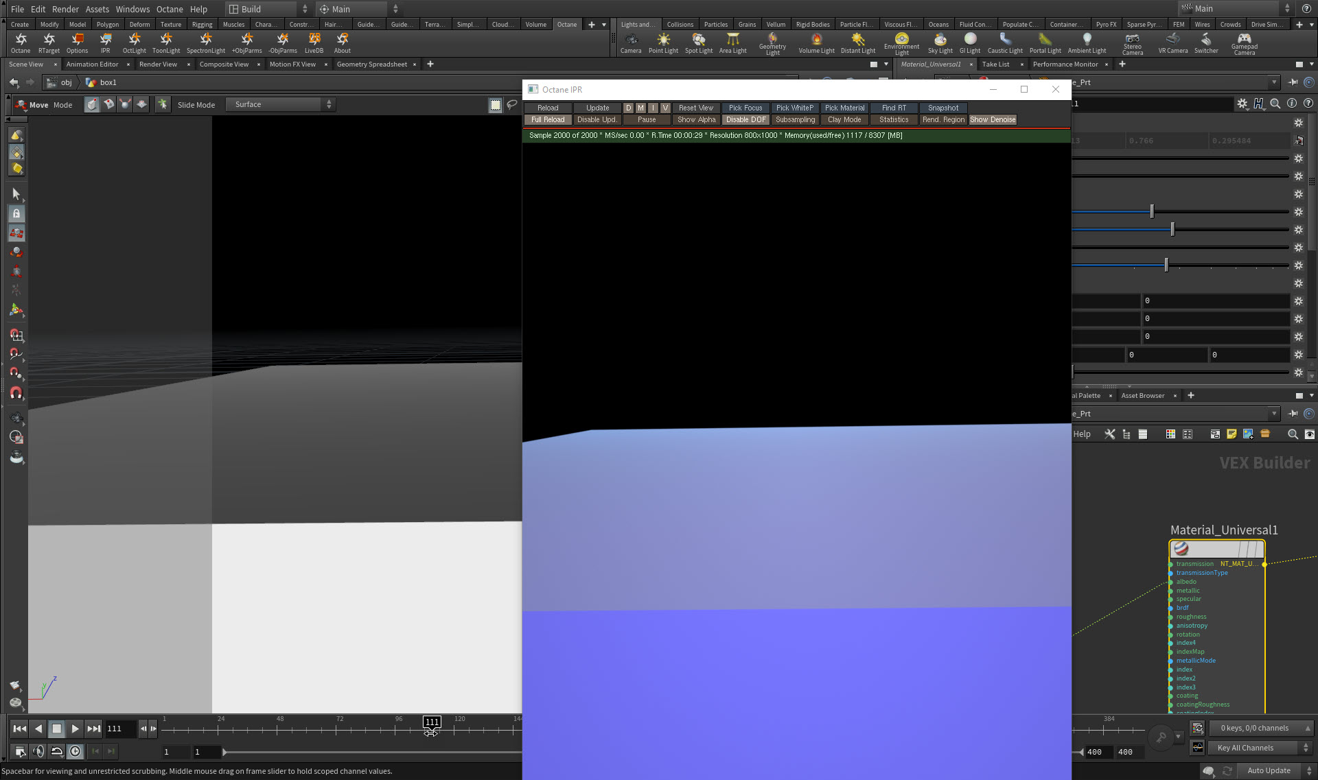

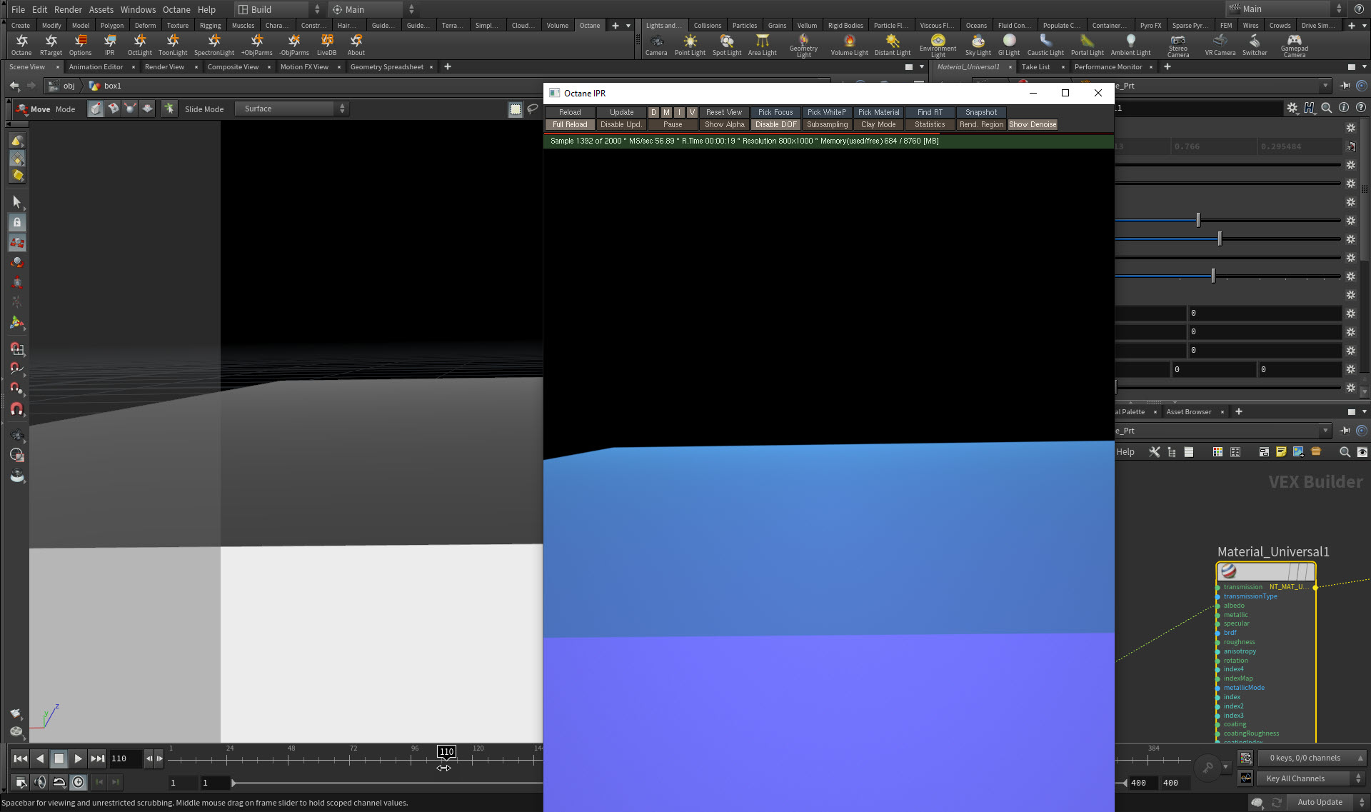

When I animate my lights (specifically with rotation) in some frames they turn dark and back to bright in next frame.
Frame 110 and 176 are the problem in this case,
Regards
Mojtaba

problem is visible here
otoyTest.zip
(87.9 KiB) Downloaded 138 times
